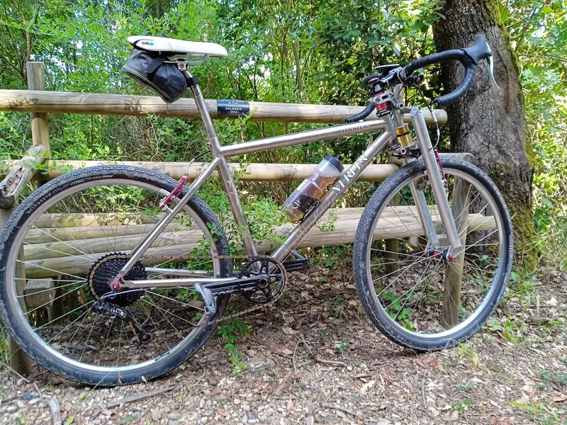

That fork, that's not a Noleen is it? Looks different. Very pretty though I like that exotic different looking gear.
It's a Girvin Vector... Vbrakes can be made to work with canti levers with adapters, like Travel agents. And yes, I remember the canti bosses were movable.
