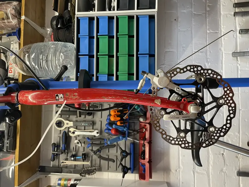

I'm modding some stock Specialized Rockhopper forks ( I know and its my fault if I hurt myself but they are built solid ) with the intention of touring. Is it worth adding any extras like bottle bosses on the sides of the blades before paint? Or is there a really good rack that would benefit from mounts in a certain position? tempImagefmsTWw.webp
Got to be worth sticking a couple mounting points for either a rack or bottle mounts if you've got the skillz! (Wish I had!)
Two at the dropout and one on the leg is all you should need.
(There's probably a brake hole in the crown already for front headlight etc)
Choose a rack first and then fit the upper mount to suit (it's not totally standard🙄)
If you've got a rack you can put bottles on it, or in a pannier.
Brazing the upper eye behind or in front of the blade avoids making a hole and applying a lot of heat to the leg itself, although it might not matter...🤔
You're 100% right, its just deciding on position etc. I guess the sensible thing would be to get a rack that works well with this fork size, offer it up and see for myself. I was wondering if anyone had from touring experience have benefitted from additional mountings?...
Did the lowrider mods 20 years ago on my Marin, in those days the other mount would have been for a bottle dynamo but now there are plenty of hub dynos.
I suppose you could alternatively fit all the fork leg bosses, but by the time you have done them and painted the fork it's probably easier to buy a Surly fork.

Thanks everyone, some food for thought there. I’m tempted to put a couple of bottle bosses on each side then should the need arise I can use a couple of modern fork cages like restrap and others sell. Realistically I don’t think I’ll run large heavy panniers up front but the forks do have a lug for that or a mudguard near the dropouts already so I’m probably over thinking it.
