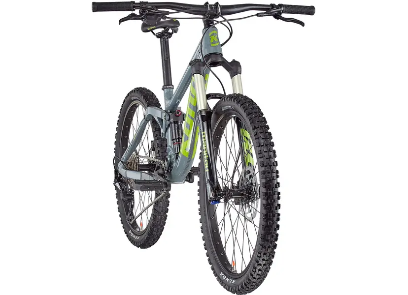

Manitou machete are made in 20" and 24". Comes in some bicycles like the kona process that it is a 24"
I have got spinner air 300's 24" available and also a pair of fox talas 26" which I have used on my daughters bikes. The spinners are a simple air spring with no rebound but work well enough.
