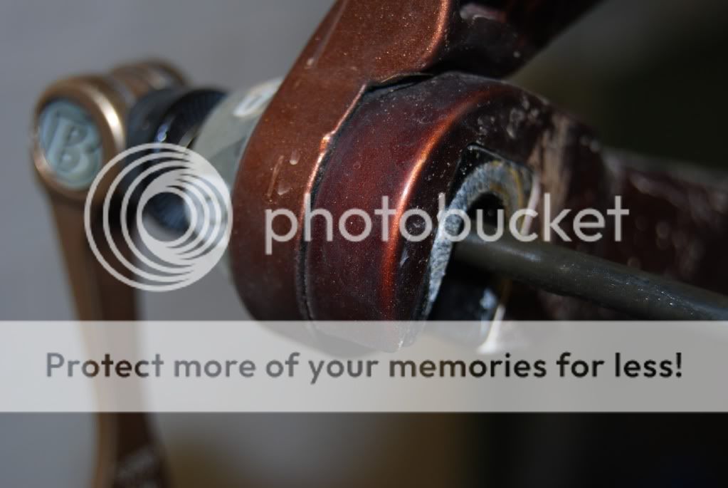

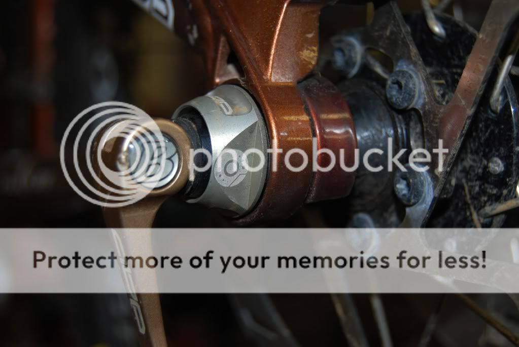

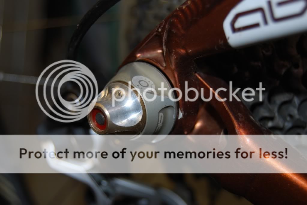

Daj if you get the chance, you couldn't take some pics of the rear skewer and the nut assembly could you? I'll try to get some pics of what I have in case you can offer advice.
In the picture above I believe the following is correct, but please correct me if I'm incorrect.
I think the hangar/drop-out labelled 1 should be in the frame to use the 'supplied' QR skewer with a standard thread. On the end of the skewer winds part 2 and part 3.
I imagine the drop-out labelled 5 is for single speed.
The two bolts and washers labelled as part 4 are for fixing the rear shock to the top of the swing arm.

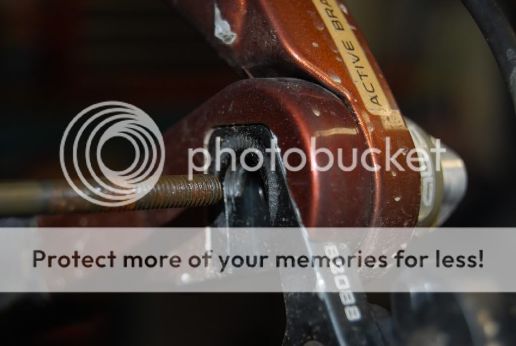

The photo below shows the current thread in the nut/hangar/drop-out combo! As you can see it's a wide thread, too wide for a standard skewer.
Hi Daj, thanks for that. Is there any chance you can get a photo of the inside of the dropout/hangar where it passes through the frame? Sorry to be a PITA!
Daj ignore my last request, I think I have it sorted now. Took me ages to bash out the dropout that was installed, whoever stuck it in made a real hash job!
