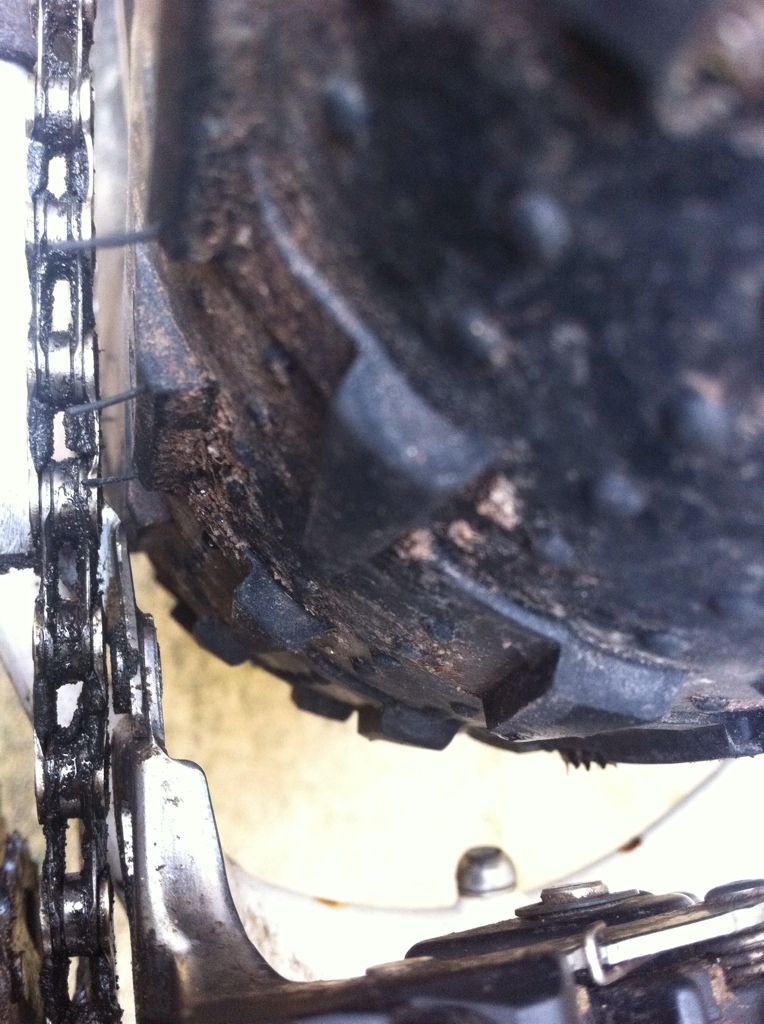

Bellow I will list some terrain types and list the tyre type that I have found is best for each.
Soft newly fallen snow = Big wheels with thin low pressure snow tyres (or better still a ski-bike).
Intermediate snow = Big wheels with thin low pressure snow tyres (suspension is useful if the underlying ground is bumpy)
Refrozen snow = Very low pressure tyres
Hard compacted snow = Any spikey tyre at low pressure
Ice= Studded ice tyres at low pressure
Lying water =  Thin rain tyres and good mudguards/flaps
Thin Gloopy mud = Big wheels with grippy low pressure tyres and good mudguards/flaps
Intermediate mud = Big wheels with fat a low pressure tyres with an open shallow tread and and good mudguards/flaps
Wet Heavy clay = Fat low pressure tyres and lots of tyre wall clearance
Sticky heavy clay = large diameter, thin low pressure tyres with an open shallow tread and at least 2" of tyre clearance
Ploughed soft soil = Fat low pressure tyres
Hard bumpy soil = Fat low pressure tyres (with suspension?)
Fine dry sand = Mega-fat low pressure tyres
Fine wet sand = Most large diameter tyres
Coarse  sand = Very fat low pressure tyres
Shingle = Fat low pressure tyres
Deep gravel = Wide low pressure tyres
Shale = Fat low pressure tyres
Small pebbles = Very fat low pressure tyres
Large pebbles = Fat low pressure tyres
House brick style rocks = Fat low pressure tyres on narrow rims
Rough and hard rocky surfaces = Fat low pressure tyres
Smooth hard trails = Tacky high pressure tyres
