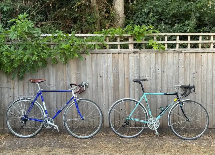

2003 Bianchi San Remo Tourer

What's the braking power like. I think I read somewhere that Campag ergopower levers work very well with cantis without having to add gubbins to the cables. Or am I just fantisizing?
It brakes very well, I think the Avid Shortys are excellent. Not sure what "gubbins" you are thinking of but I assume that the cantis require the same pull ratio as the more normal road bike calipers.
