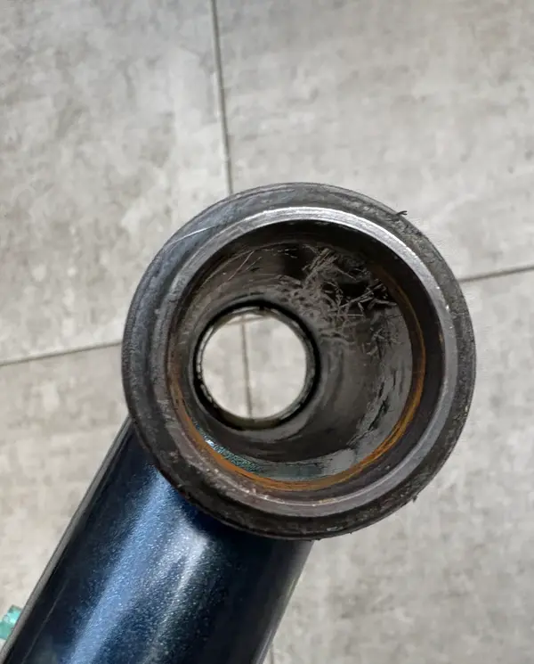

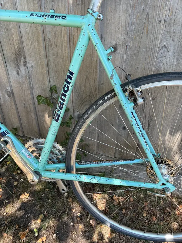

It looks very much worse than it is. None of the rust patches are that deep. I would be very confident that internally, the tubes are fine. Here are views inside the BB and headtube. Its not even that old...less than 25 years! :D

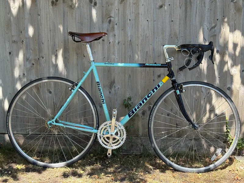

Here's what it looks like so far, with a borrowed Brooks
Sometimes the tools work!

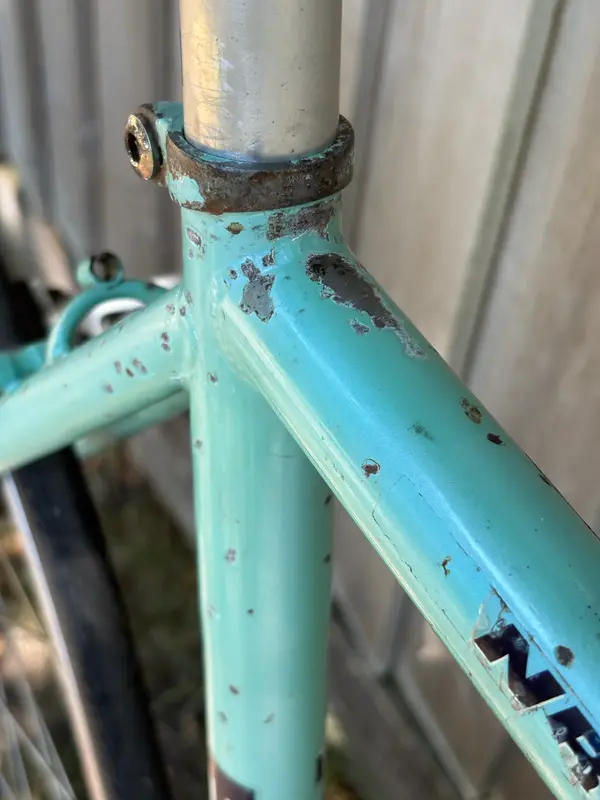

Here's some close-ups of the "patina"
