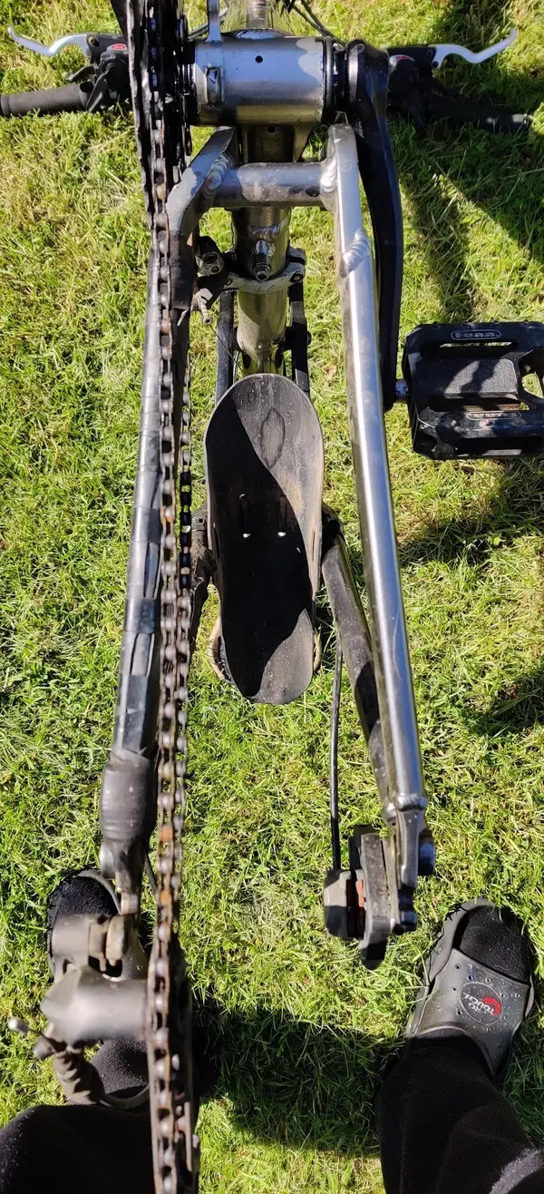

Also could you post a picture of the chainstays from underneath your frame? I have the same frame and one of the stays seems more bent in than the other. Thanks

Flipped the bike upside down and took the back wheel off, here's your chainstay pic, let me know if you need any more 👍

The standard shock length and stroke is listed as 191mm x 51mm so no different if you change to a different shock with the same figures. The rear stays on some of the A.C. frames were asymmetrical and others had similar straight stays. They are prone to cracking through age and use around the welds on the strengthening stay between the chainstays. Look carefully and check over when clean and dry to make sure if it's cracked or not. Mine has a small crack but been keeping an eye on it and I don't ride it hard these days but I'm intending on getting the frame welded and strengthened soon before it gets worse.
