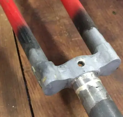

(...) thinking of replacing the whole steerer. Is there a way to do it that doesn't damage the paint work?
This is what my fork looked like after a framebuilder replaced the steerer with a longer one for me. It was all red before. It needed new paint anyway, so not a problem for me:
