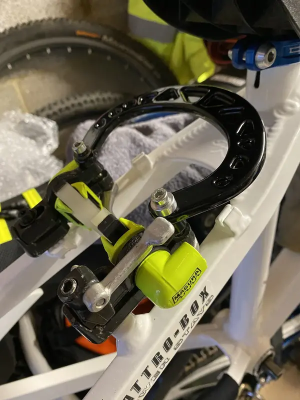

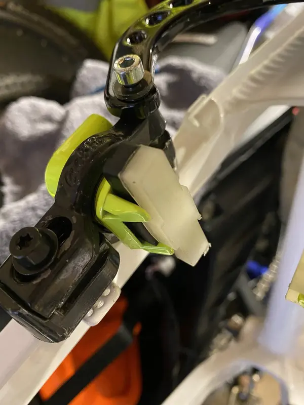

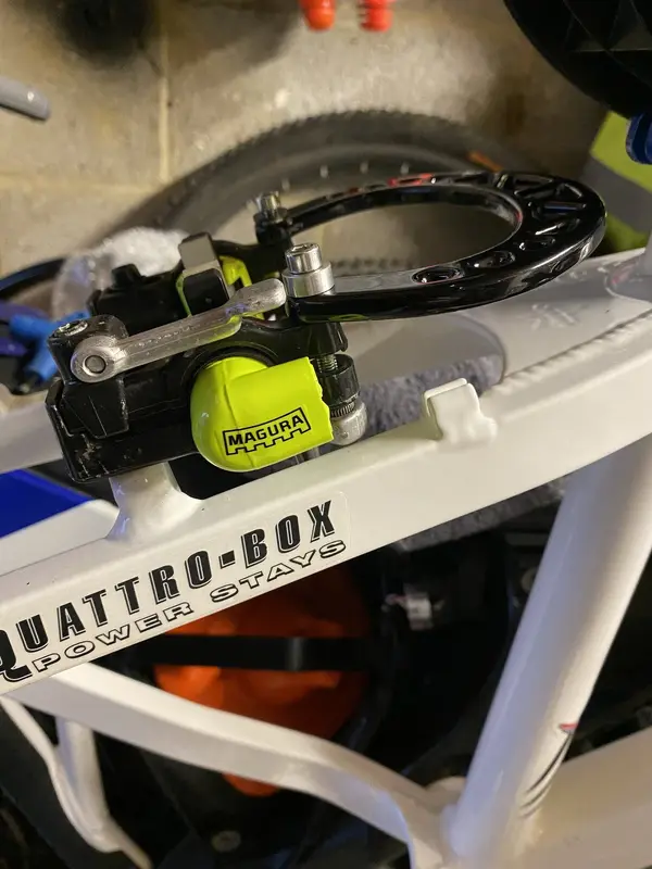

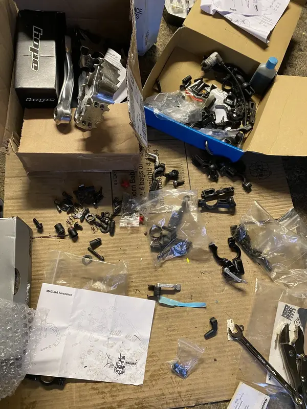

So today didn’t exactly go to plan whilst mounting the maguras.
The powder coat on the mounts is way too thick. I must have spent an hour with the dremmel sanding them to fit, but it didn’t work. Even snapped some mounts šŸ¤¦šŸ»ā€ā™‚ļø. So I’ve had to rummage through the spares box and use some old mounts. At least I get an idea of what they look like šŸ˜.
The plan now is to get these old mounts wet sprayed or try and find some NOS mounts.

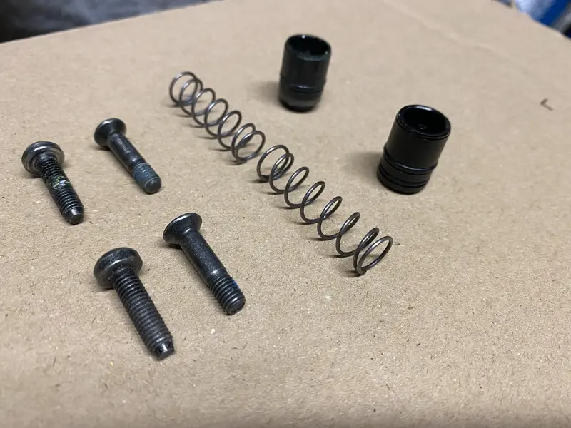

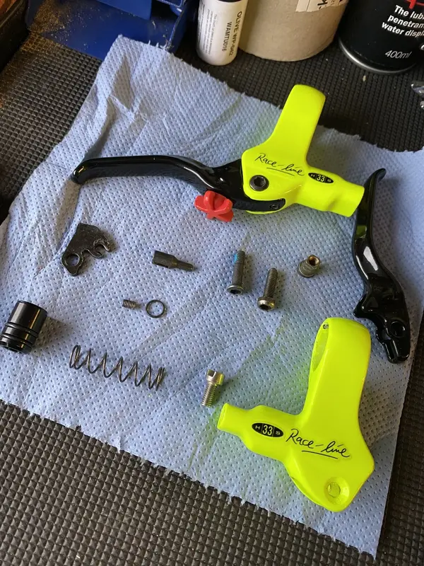

Also fitted the up rated metal pistons and springs, plazmatic pads, new pivot bolts and leaver clamp bolts.
A few jobs done today.

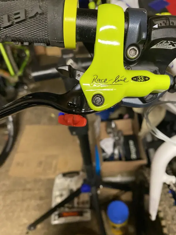

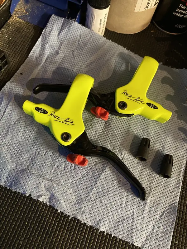

Got the other set of leavers fully built up with the up rated metal pistons, springs, home made tpa’s and all new bolts and fixings.
Started plumbing all the lines up, but got stuck as I have no vice so couldn’t fit the barbed fixings into the hose for the cross overs.
Also test fitted an xlite phatso to see if there’s any clearance, looks like I have 1 or 2mm to play with and that’s with the slaves pushes up to the clamps. May not be able to run a phatso on this build now.

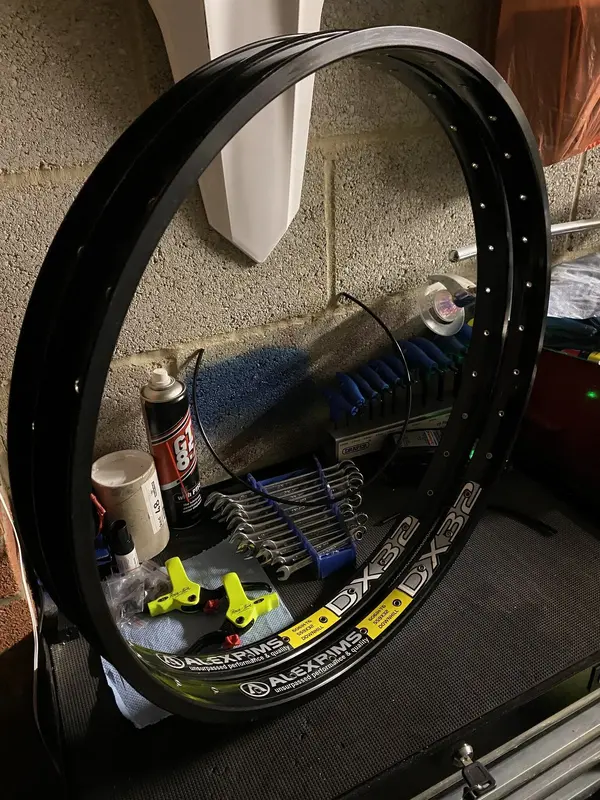

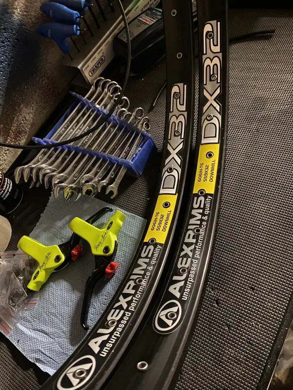

First up, another set of rims. I now have 14 rims šŸ¤¦šŸ»ā€ā™‚ļø, but I couldn’t resist these. These look NOS to me and the only cost me Ā£30 posted. Alex DH32’s.

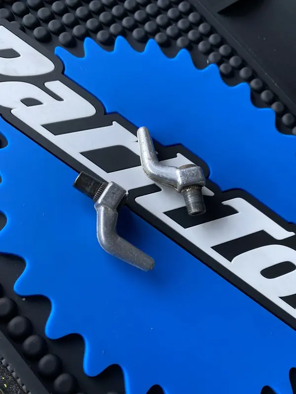

Some metal elbows for the magura mounts from my friend Wayne. These were needed to finally mount the front brakes.

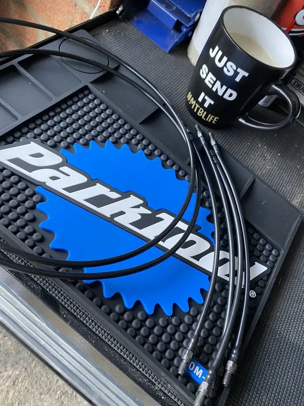

And my ready made crossovers from Ben @ trials addict, absolutely amazing service. If you need magura parts, he’s the biggest stock holder of magura parts in the uk.

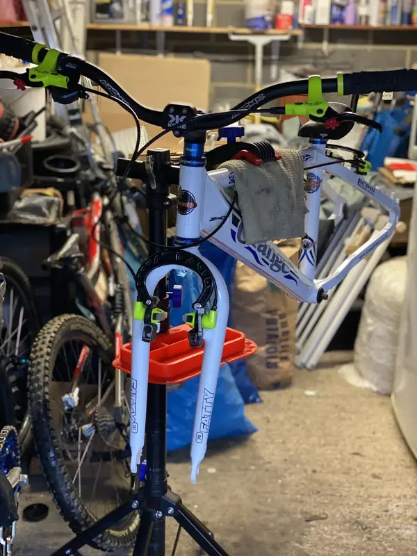

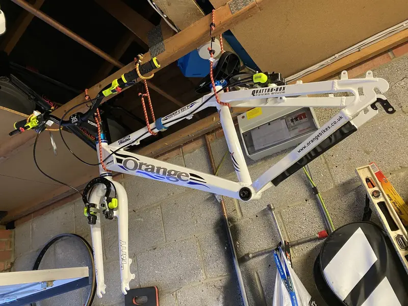

Then New Year’s Eve it was time to finally fit all the hoses and bleed the brakes up. Also fitted the magura cable guides for the rear brake.
And put up out the way until I get the wheels built, once I decide what I’m going to use.

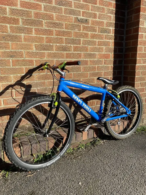

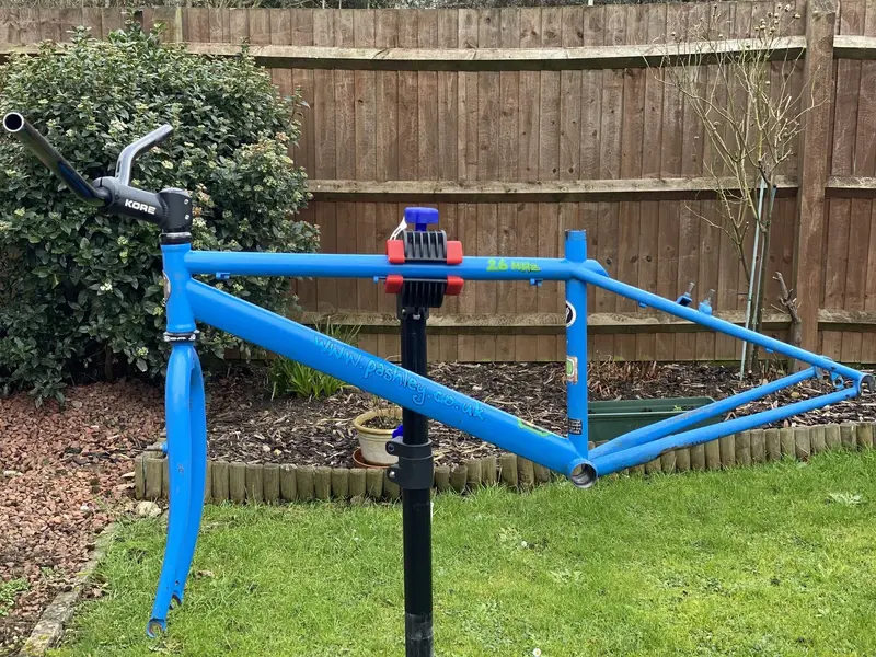

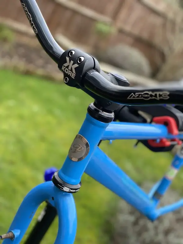

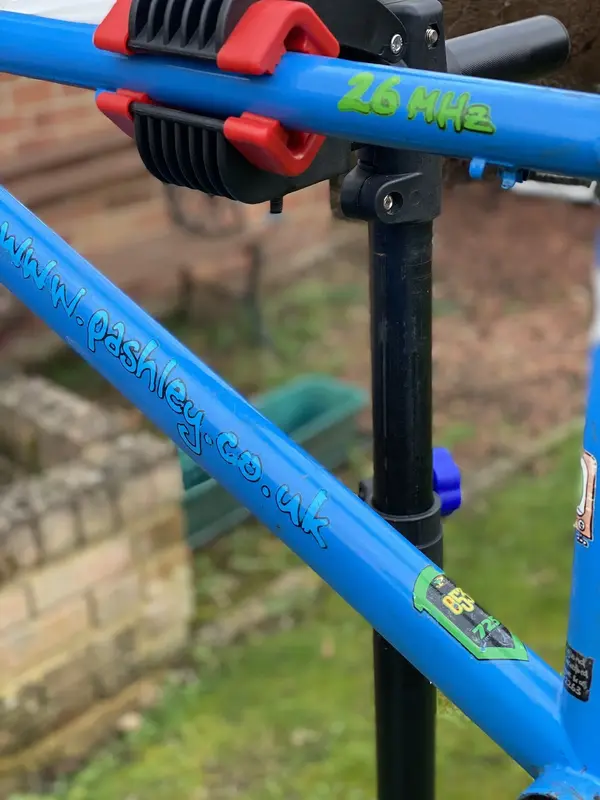

So first up, a pashley 26mhz frame and forks, bars, stem and headset. I was contacted about this earlier this month and I had to have it.
A nice chap called Dave helped me out massively and collected the frame from where he lived and met me halfway. Legend.
4FE110E7-2824-4EA8-8281-B72B120AD197.webp A405B299-D9B1-4CBF-8674-5E0CADCBD560.webp

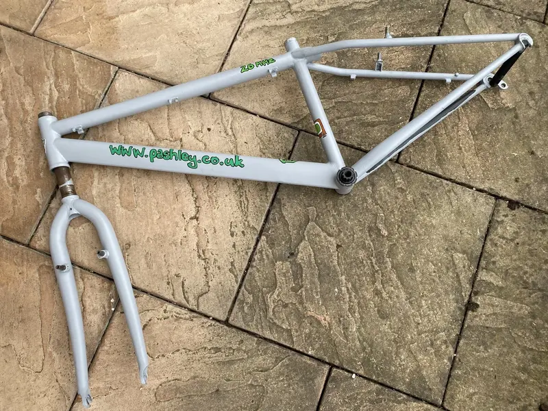

Whilst the deal was done with the blue one, another one popped up. So a deal was done and now we have 2!

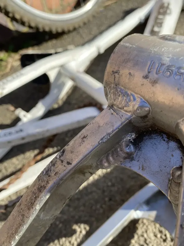

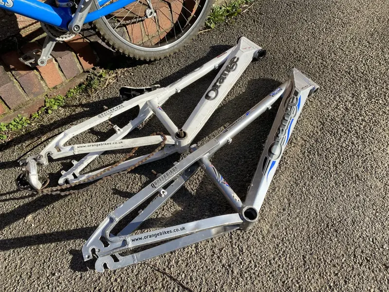

2 11ā€ orange zeros! Unfortunately the silver one is cracked, but it’s repairable. Undecided what I’ll do with the silver one yet.
The white one has bad oxidation on the paint work, but I was always going to get it re painted and re stickered.
