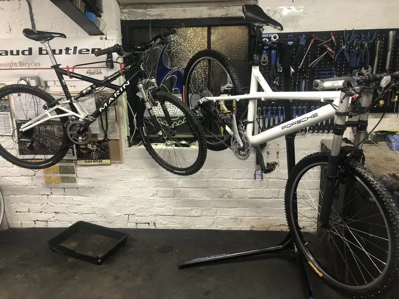

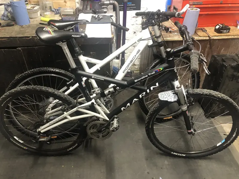

After spending a few hours riding behind @yakboy 's Porsche today at Dalby forest, it got me thinking about getting this one trail worthy.
I always planned on losing the LX kit but wasn't sure what to replace it with, Yakboy & @Retro Spud both went down the German group (well at least the non Shimano route) but I'm still in two minds..

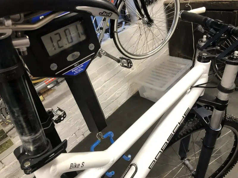

Not sure what Spuds weighs in at, but Yaks is sitting around the 11.5kg mark (give or take an SPD) Ours however is a slightly portly 12Kg.
Now if I put on all the XTR from @Our Jimmy 's retired Marin (including swapping out the Magura's) I'd easily shave off 1.5kg = 10.5Kg and with a little more frugality possibly get it down to 10kg (or 22lb in old money)
But I don't know.. the naughty in me is thinking why not go all Campagnolo but keep the Maggies? But would that be just too much Italian flare for such a Teutonic tank? IMG_2828.jpg IMG_2832.jpg IMG_2833.jpg

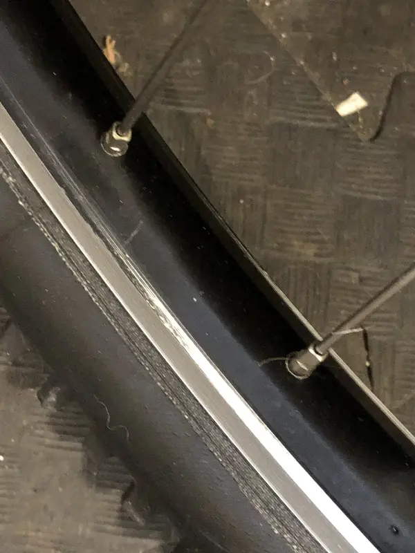

Now your pressing my “correct button” so maybe I should just clean it all, give it a good service…
But I still want to swap out the damaged bars, the worn Mavic X139 rims (badly set up Maggies) & the saddle, sell all the Campagnolo & XTR and enjoy the cash? 4930E406-CC7B-44F8-8252-65A3A311277E.jpeg
