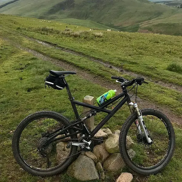

Love the build, my Mount Vision was my first proper MTB back in 1998 and while many bikes have been added to my collection, could never see a day when I’d let this one go.
I spent a good while (and a fair bit of cash!) doing mine up including a later model swingarm to accommodate discs.
She rides beautifully and performed superbly on the Sandstone Way this summer, keeping up with my mates’ more modern enduro machines.

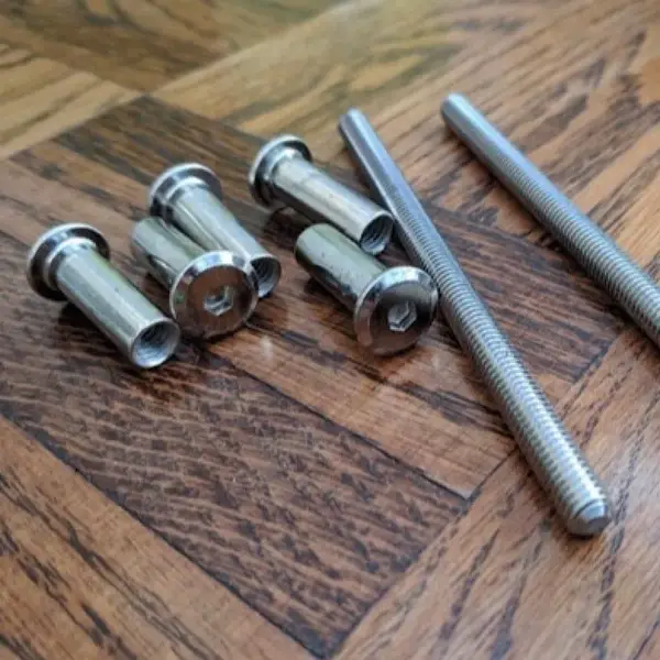

One thing I have never been happy with though is that, since the rebuild, in which I managed to ‘misplace’ (ahem) the shock mounting bolts and other hardware etc, I’ve always had a tiny amount of play in the shock mounting.
Can I ask if you’ve got the link for where you bought your sleeves/top hat bolts from - of course China is a pain to wait for but if it solves my bodged set up of bolts and washers it would be a godsend!

I bought the sleeve nuts & threaded bar on my wife's amazon account, I'll ask her to dig out the order details and will let you know what I ended up with.
I have had to tighten the pivot bolts for the swing arm up a few times (even after adding threadlock... maybe I am being a bit too gentle with them as I haven't gone tight enough to bind them at all yet).
However the shock mounting hardware that I bodged together seems to be working absolutely perfectly, which is pleasing :)

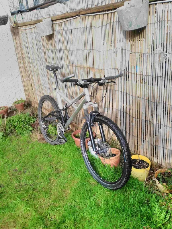

I mentioned when I'd just finished this build that I was never quite happy with the cockpit. Either the bars were too wide (especially noticeable when on the bar ends) or I couldn't get the brakes and shifters far enough inboard if I moved the grips inwards.
Took the bike to the local trail centre the other week and also felt the riser bar was unnecessary - although I'm cool with running risers and bar ends, I want this bike to ride like a proper xc race bike and the riding position, while perfectly comfy & extremely capable, wasn't quite as stretched out as I'd prefer. To be fair it's a pretty tame trail centre (haldon forest near Exeter) but I felt rather overbiked!
So while it's been bucketing it down with rain I stuck on some 580mm flat bars to see how they'd feel. Only done a quick town ride so far so can't comment much yet but feels good so far and looking forward to hammering some of the local bridleways when they dry up a bit.
I believe these bikes were originally specced with 120mm stems rather than the 100mm I have at the moment. Not convinced I want to try that though - I remember losing rear wheel traction on steep climbs last time I tried this set-up, and there are some steep fast descents where I'd feel a bit nervous that far forward on the bars.
Also stuck some new brake pads on the rear caliper and gave the bike a bit of TLC before the new season starts.
