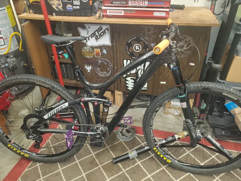

Yep, wife's new (used) bike to replace her other bike she rarely rides. This is upgrade #3 for her, just selling the old ones as we go. It is VERY nice and completely unnecessary lol. Fun little project though, went through and refreshed the drivetrain and suspension, clean and re-greased the pivots, changed to a shorter stem. Super easy. The dropper and 29" wheels will be a big change for her.

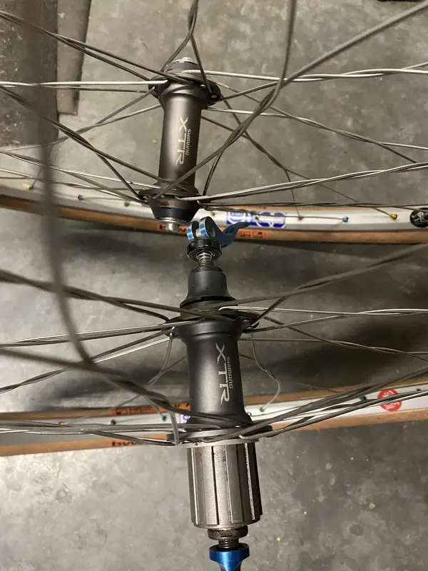

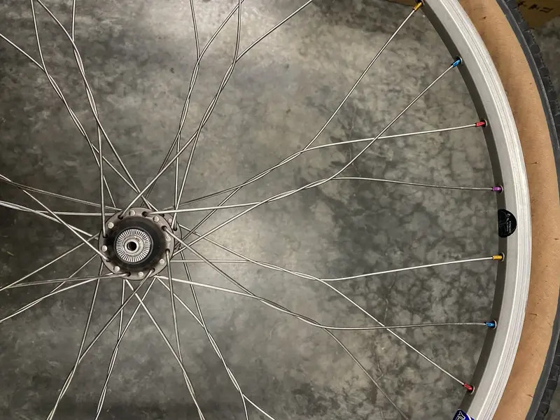

Can't leave us hanging, gotta share a pic of the twisted spokes Obed :)
4E1F9079-57B3-4475-85BE-A372E6940F11.webp FD758325-0DF2-442E-BD12-799AA4D2D2F2.webp

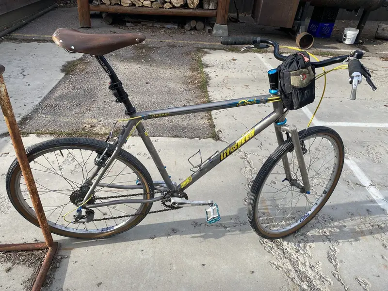

Tease 1.0, just because these pics are on my phone... Obed is parked outside the brewery right now after a changeover from studded tires this morning... stay tuned. It’s definitely a bit of a bastard; partially period correct, but also... not. Similar to your Score!
XTR M950, Thomson & CK... All mounted on a sweet ti frame. Propper build for the discerning bar hopper!
