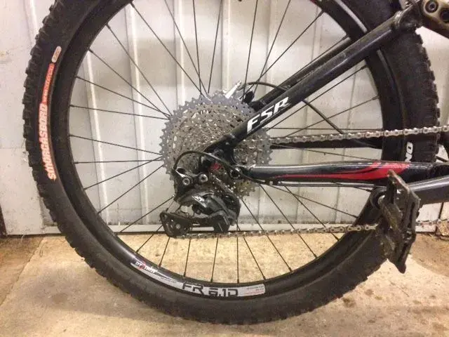

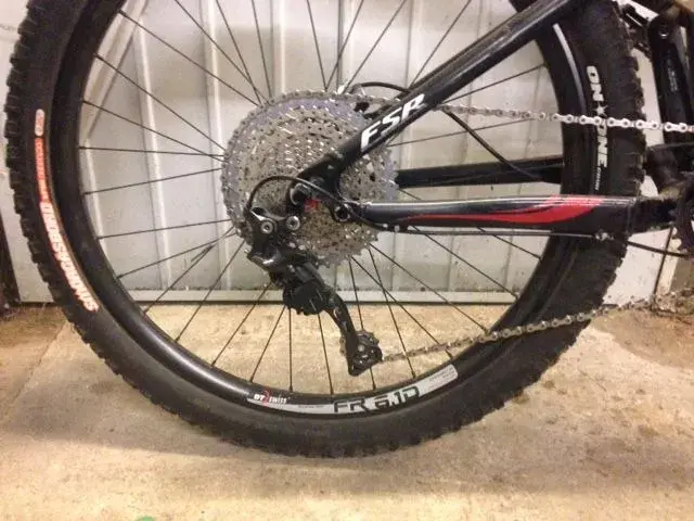

Just to add, if you go 1 X10 with a 46t low gear you will need to fit a 11 speed rear mech (it works) but the bottom pulley will be very near the ground with a 26".
Re: Re:
yep.
Works well, and the mech isn't really that low. FYI, it's half an inch lower than a GX (12 speed) mech is on a 29er (but yes, they're lower than an older mech).
