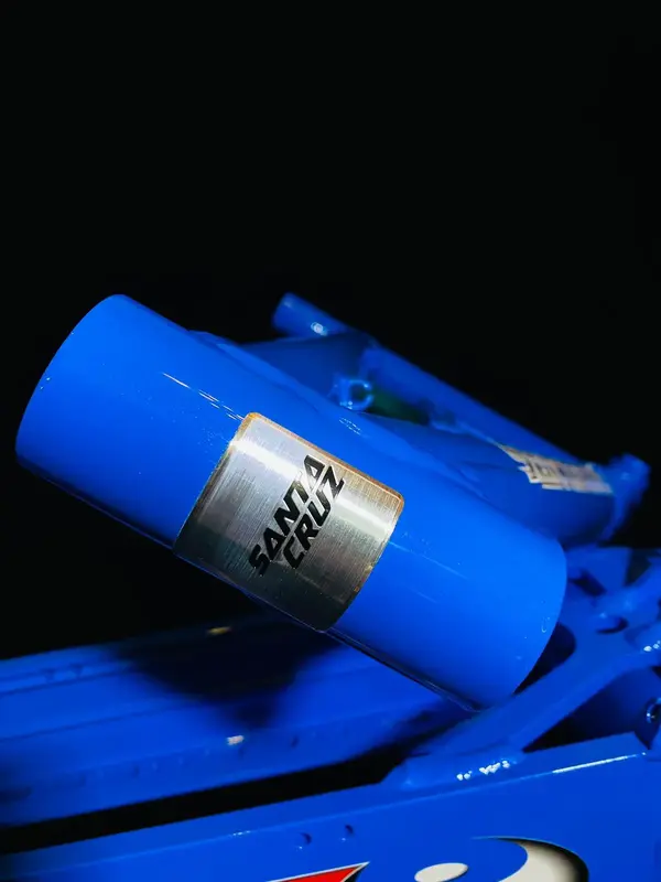

im also thinking of using a current head badge rather than the original style sticker - but that can be decided later.

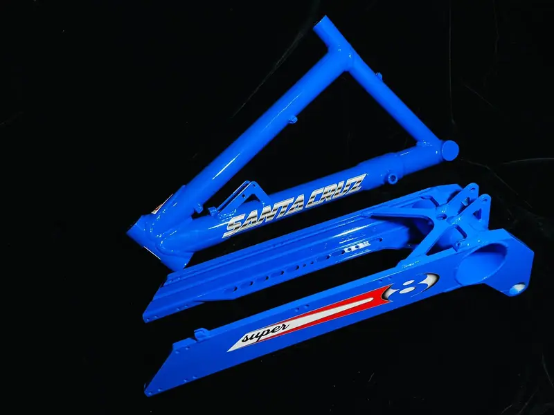

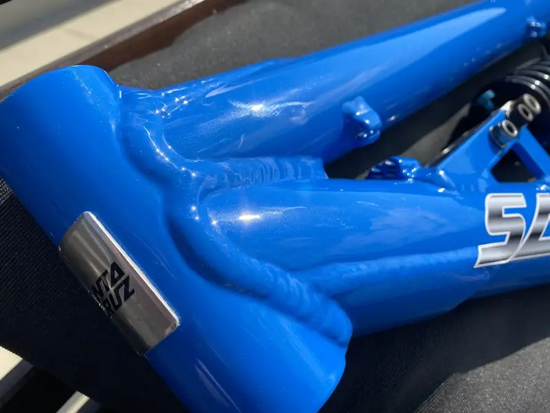

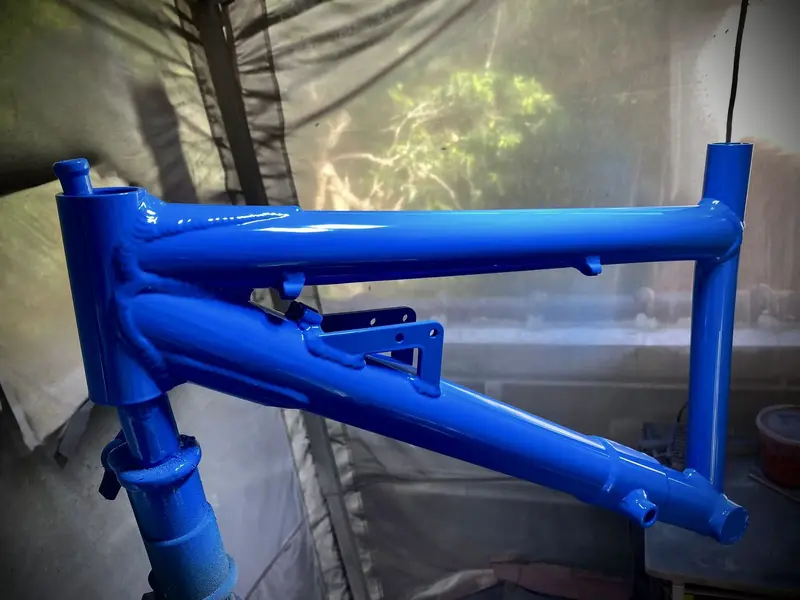

Ok - I picked up the frame last night. happy with the colour, it 100% on the pearl but I need to see it in daylight. It’s also a bit on the thick side but I can live with that.
The decals are unfortunately not right. The downtube decals are the wrong design and are too long so they overlap welds at either end, and frustratingly, the swingarm decals have been put in completely the wrong place so I’ll have to redo those. I’ll get stickers made up specifically rather than buy from eBay again. I’ve had zero luck with ebay sticker sets being right(I supplied the decals, the painter just applied them).
The guy a,so forgot to bring the new bearings and shock mount - doh. So it won’t be built up for a while!
Anyway, here are a couple of pics from him and one i took quickly trying to show the fleck.

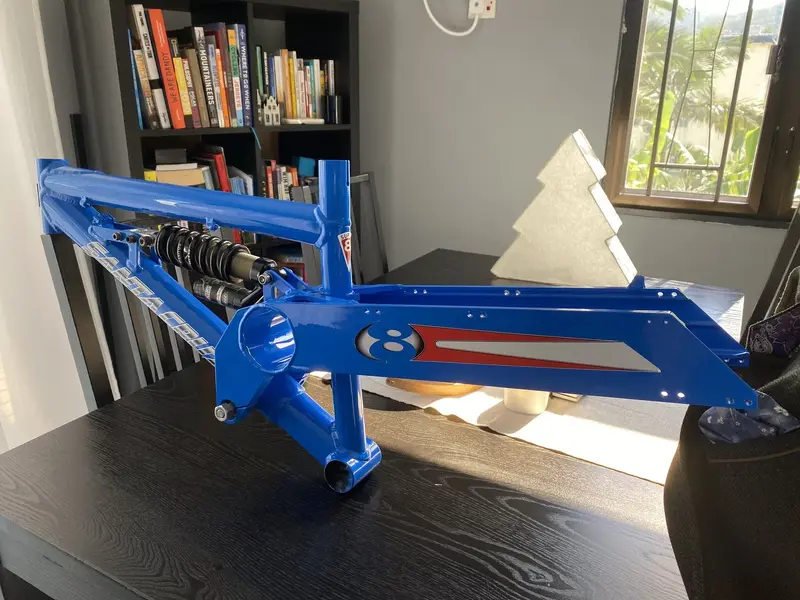

bit of a test build this weekend. I’m really pleased with how well the new shock mount fits, and i think the whole frame looks fab.
I will put better decals on in due course - I relocated them and it hasn’t gone well. I’d also really like to fit new bolts throughout. Maybe black. Maybe oil slick.
Unnnnnfortunately. I didn’t do a good enough job of cleaning the inside of the VPP pivot. I hammered the axle in as far as it‘s gone and it will now absolutely not budge in either direction, even after moving up to a larger mallet.
I really don’t want to have to use a blowtorch or press it out because it’ll damage the new paint!
Dis bigg boi ain't no vpp bludd.
He be single pivot fo lyfe yo!
As far as the stuck axle goes, you'll have to drift it back out, in the direction from whence it came.... Well, that's what I'd do anyway. Hit and hope!
Also, How'd you get on sticking that HT badge on the old frame? Those new badges are designed for modern tapered headtubes, is the Supereight just fat enough for it to be ok, or does / did the badge need some modification?
It’s an after market one so just a flat square. A bit of a squeeze and on it went!
