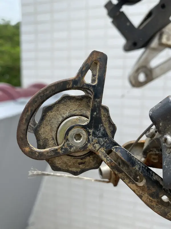

Stripped down and properly inspected this weekend. It’s the first time I’ve actually had a chance to look over it properly. As I already knew, cosmetically it’s in a ‘right state’ - cables, chain and rear mech fit only for the bin.
I’ve never even seen a jockey wheel this worn before;

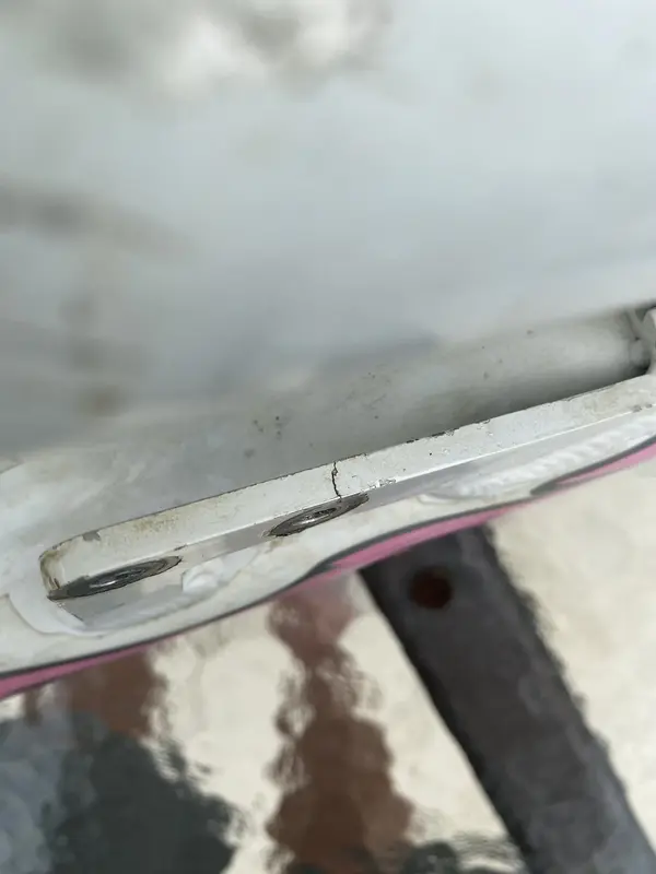

With ‘structurally sound’ from my original post still ri going loud, of COURSE the shock mount plate is cracked through one of the holes;
So if I want to actually use it, i need to decide whether a weld, welded patch or replacement plate is needed. Which has to happen before paint.

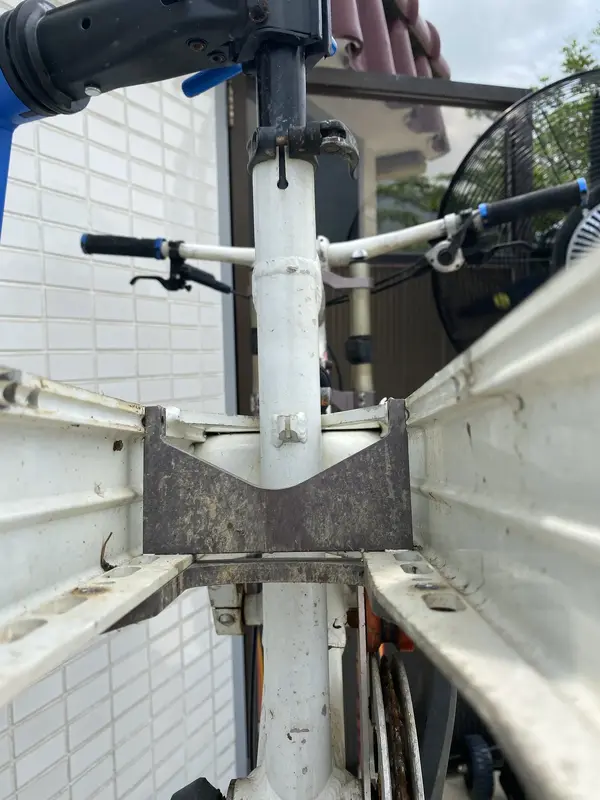

Which leads nicely into - the Inside of the swingarm is waaayyy more complex than I had realised from the pictures I’d looked at. I don’t think the paint scheme I had planned is going to work at all, So I’m probably going to go with Nardo Grey without the highlights, and use components to add the colour - which is a shame! I’m going to speak to the painter this week and see what he thinks.
All in, though, it’s a fantastic bit of early DH kit. Oversized everything and multiple machined parts. The rear brake callipers arch is 3 pieces that bolt together through the swingarm, bolt-on dropouts. Bonkers.

On the shock mount plate: run a straight edge across the top of it, and if it is distorted, check the other side too.
It should be possible to paint the inside of the swingarm a different colour, it's more work and hassle for someone, but that doesn't make it impossible. Having that area highlighted would show off how cool it is!

Frame has gone off for sandblasting, then the shock mount is being welded up and redrilled.

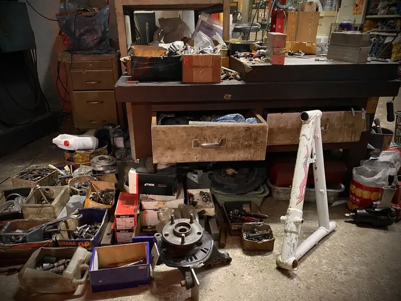

Here‘s a renaissance painting-esque picture of the frame at the metalshop!
Predictably, colour-wise I’m having second thoughts on the grey, so I’ll leave it as a “watch this space”. I’m off back to the UK soon so won’t pick this up until November. In the meantime I’ve got this and several other projects to find parts for!
