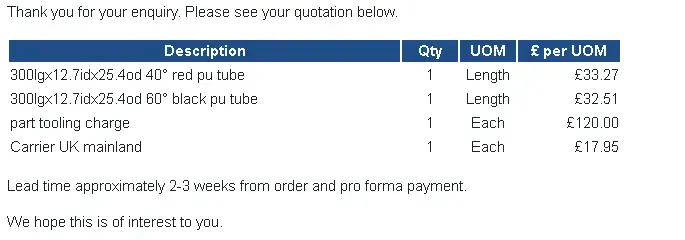

Ask the few elastomer makers on here. I have a replacement set (I think) so could measure up.
I of course could well not have a set, it could be for something else.
Pick the nearest one to you, chap in Sheffield, chaps abroad.

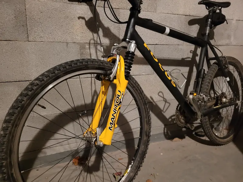

Please, I do have SXR (I have identified it as 99/00 model, with disc brakes mounts) on older (and unidentified) Focus bike.

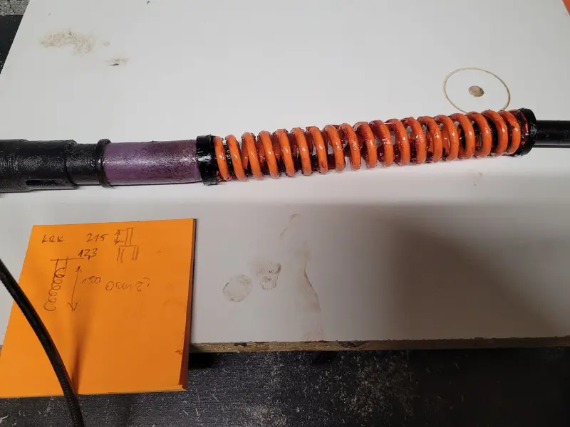

My question: I do find it a bit stiff (strong? sorry being not native speaker) - and I think it's spring probably.
Are there any options - of course not original after 25 years :)
Spring is 150mm (6in) long, 12.3mm (0.49in) outer diameter.
I have orange one there and I am 70kg (155lbs). I read all manuals, all threads, tried TPC and damping, changed the oil to 5WT, then 2.5WT and still a bit tough.
But I haven't found any info on this. Usually only yellow / red / blue but orange?
(Overall the fork is in nice condition, clean, undamaged, elastomers look fine - I have freshly changed oil with correct level according to manual& grease with grease gun. Somebody was taking care. And I am satisfied with the look, so it's difficult for me to change - also it's about money unfortunately.).
