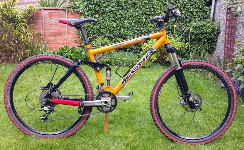

Wow, where did you turn that up? Amazing condition! I can confirm that the frame will take a standard shimano brake hose from a M765 brake. I'm running one on mine, and all it needed was the new olive once I'd threaded it through the frame.
Looks like the hose is too big to squeeze in so options are A) lightly Dremel the slot wider, B) disconnect the line, slide it through and re-bleed, a la W. Ford method, C) use cable clamps or D) take some WTB Dual Duty wheels off another bike and run a V-Brake in back and a disc up front. Im thinking "B

Manotou R Seven Pro works well. Wish it was black though - looks snazzy W. Ford!
