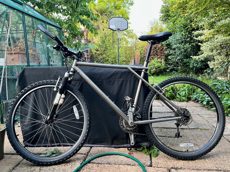

I bought this bike in July last year - although it seems longer ago than that. It turned up on Marketplace, not far from me so I contacted the guy and went to have a look. He wasn't quite sure if he was selling at the right price, but he was about right. He had seen a couple of other examples on eBay for £1500 and above and I explained that they had been on there at that price for months already and would be unlikely to sell (In fact they still are there a year later!!)
This is it when I bought it home. Well used as a commuter, but had had a yearly service at his LBS, or so he said.
It was pretty much original spec. and my plan was to clean it up and upgrade it. Decals had gone, but the frame was pretty much unmarked. The finish on these is hard to restore, so that was a plus.

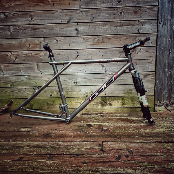

I bought some replacement decals and then swapped out the Kore stem and bars for some Syncros ones.
I also liked the idea of adding red accents like the red in the decal so wired it up with red cables and red brake bolts.
It's done for now - although I am looking for some anodised red Mavic x517 or Rolf Dolomite rims, which I think would work nicely.
