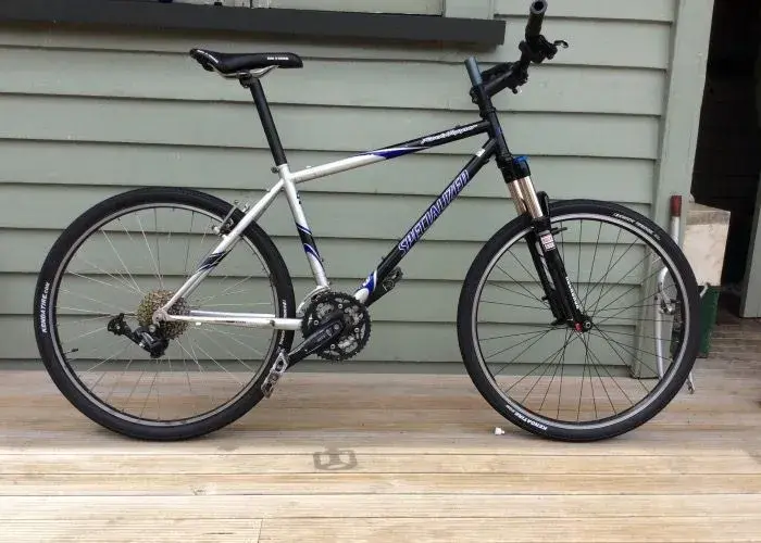

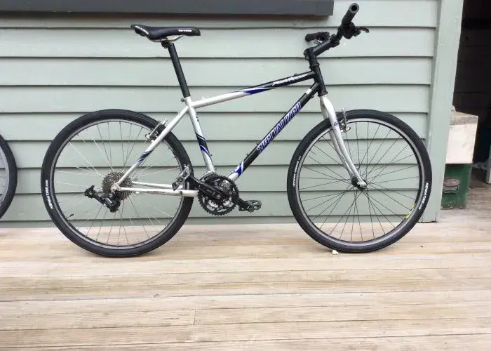

Before,and after
Pic 1 is after
Pic 2 is before
Weird ?I do not know how that happened.

Yea, Thanks for the response when I was setting up the bike I noticed that the bottom bracket only rose about 10 mm off the ground which I think will be suitable.
I have seen some negative feedback about older bikes with 100mm travel, although this frame config has the front pretty high already.
With a 100mm fork, you should be ok. Also, by the time you have some 'sag' in place the difference will be reduced further.
As a frame, they're designed with a 80mm fork. I've had both on mine, an 80mm and 100mm (Same frame) and they both where ok.
