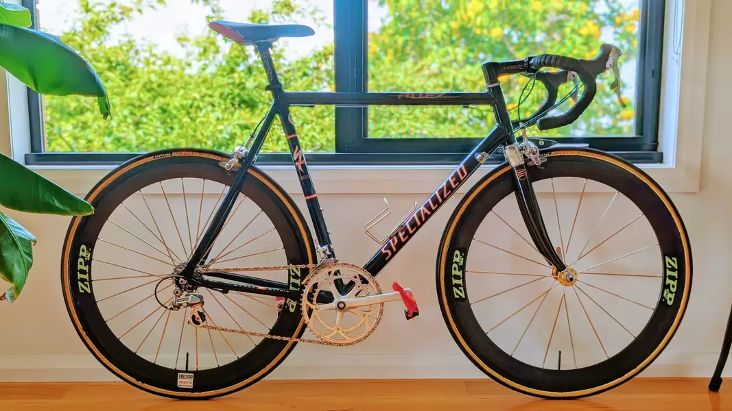

Yes, yes everyone loves a Cannondale or a Quantum. Me too, but they lack...Brutality. Enter the Allez M2 Comp.
18lb, weapons grade, highly enriched, tooth filla killa, high fructose, bald eagle, 8 GMO corn cob speeds which all lead to FREEDOM, born in the USA, top fuel nitro macho machine
Just a fun ultra-budget** build pushing the limits of trans Pacific cooperation in the mid 90s. '97 Allez M2, Thomson X1 110x-10° stem +post and clamp, 3TTT forma bars, scrappy 7410 group, Zipp 440 on Dura Ace/Ballistic hubs. Would really love to put a set of Specialized trispokes on it if the opportunity presented, I'd also like to try a nice, light set of low box rims like Reflex SUP to knock a kilo or so off, but the stiffness of the 440s matches the unyielding, no-compromise feel of the frame perfectly.
It is fast, like, seriously. It is in no way comfortable in terms of ride quality, nor pleasant for climbing on that gearing; it is my fast'n'flat go-to bike These things go like a scalded cat.
*8.2kg for freedom hating Euro types
**$80AUD frame, and what can I say, triathlon dorks*** are a parts goldmine.

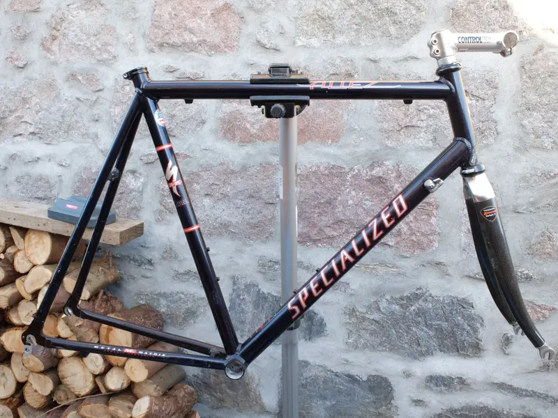

Your build is a lot like my '96 M2 Pro actually, it's got an 8v Campagnolo mix with Eurus 20 wheels and the same fork as my '97 but threaded.
I think if you find one of these Kinesis carbon forks in tidy nick they're a fairly safe bet, steel steerer pressed in alloy crown, pretty reliable bonding. They're definitely more comfortable. This Sworks on Pedalroom has an Alpina fork which looks the part too.

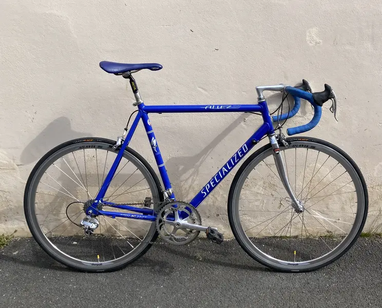

Good looking bikes/builds. I much prefer the graphics on the older Specialized frames. I picked this frameset up for a song at a jumble sale and it cleaned up quite nicely. I thought it was a fairly comfortable ride, although I was not using deep section rims. The frame can take a 28mm tyre at the back which helps. Eventually sold on Ebay under the 'one in, one out' rule....

Very nice! I am keen to either buy or build a nice low box rim tub wheelset for it for comparison (and to see if I can get it into the low-mid 7kg weight range). The Zipps are very stiff and certainly don't add any compliance to the already rigid frame.

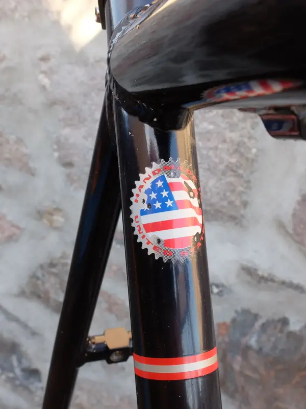

These were made in the USA. They were mostly criterium bike frames. M2 aluminium mountain bike frames were prone to breakage, don't know if it was case of the road frames.With Dura Ace 7800 and Zipp 404 wheels , the bike might be lighter
Well, it might, it could lose about 500g or so, but it would definitely be uglier and less fun as a build ;)
I just got some really nice Sun Mistral/600 wheels, I might sling some Veloflex clinchers and light tubes on and run the weights. Suspect they might knock some chonk off it.
