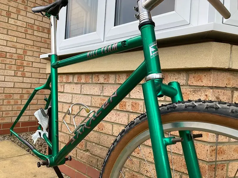

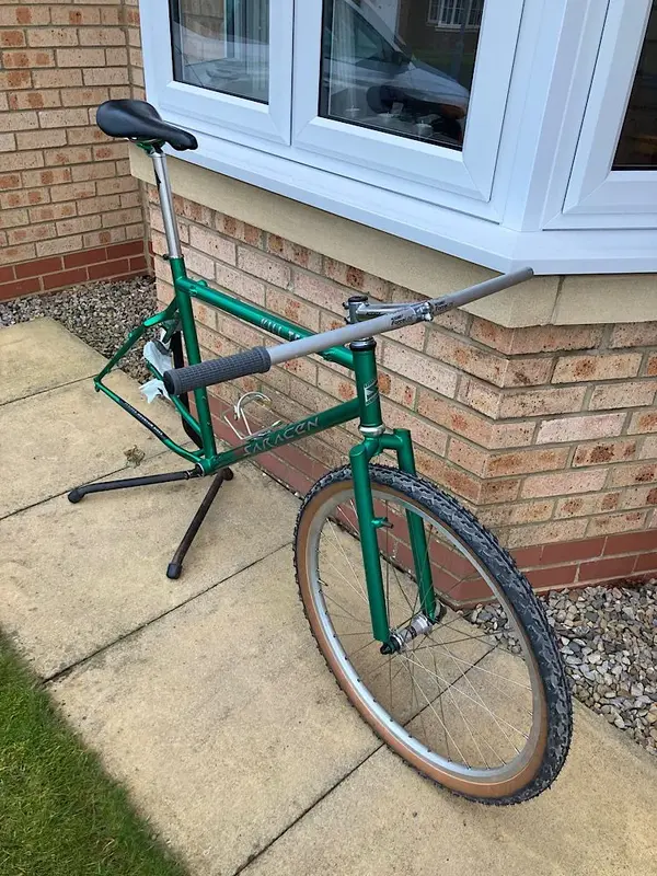

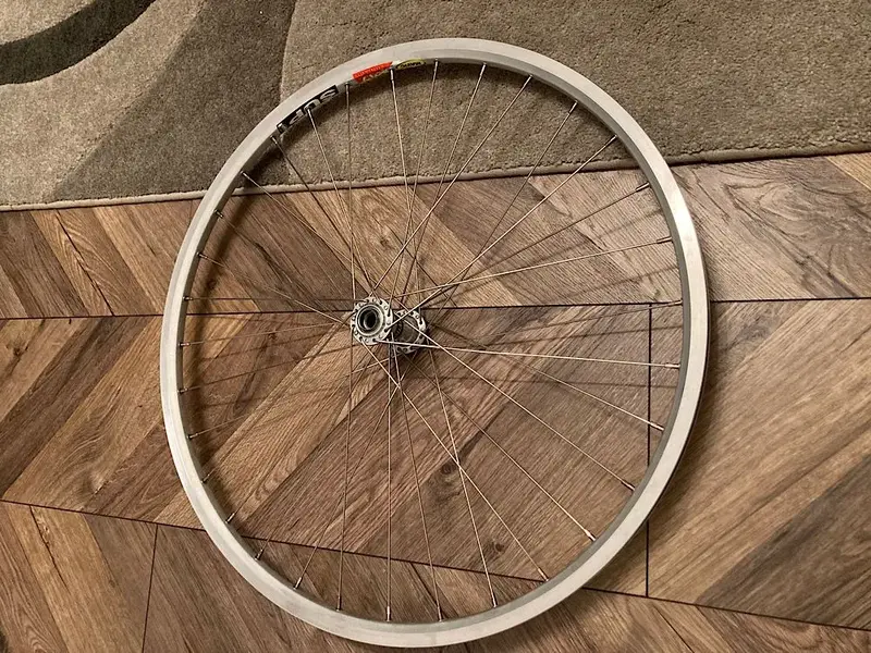

The front wheel has been stripped and I’m happy to say that it’s like new inside. The rim face once introduced to a little wire wool and water is like the day it left the factory.
This truly has been a pampered one owner bike!
I’ll stick new bearings in just because and then onto the rear….

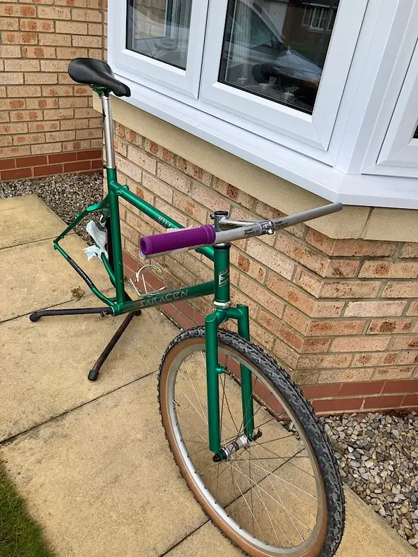

Today I managed to replace the front bearings (cones are in great condition). The bearings were fine however I don’t see the point in not replacing them when doing a full resto as I buy them in bulk and have them in my stocks anyway…
I also fitted the NOS Tiagra tyre (have a rear also) and messed about with some grip choices I have in my stock but think I’ll go with the grey lizard skins as I’m not brave enough to fit the pink ODI’s however I’d consider red or green ODI’s????
Here’s some pics as the sun fades for the day…

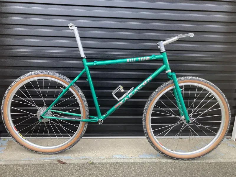

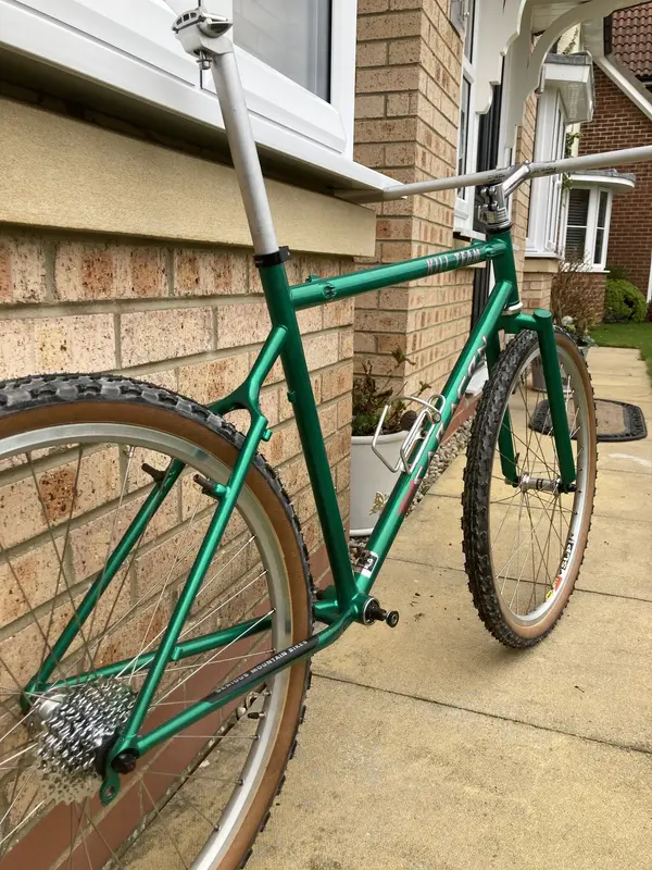

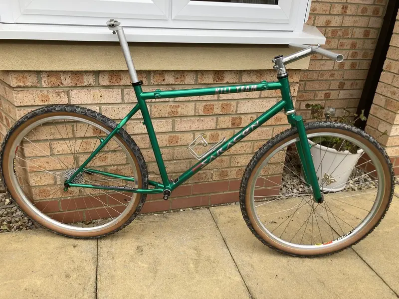

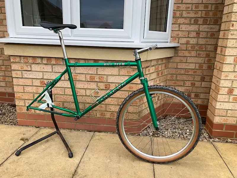

Bit of an update today!
Serviced the rear wheel and polished it up. New bearings, tube and tyre fitted. New 11/28 sram cassette too.
After messing about with seatpost I realised that the one that came in the bike which was 26.4mm was not the original so the Fred salmon post I bought was also incorrect!
The correct seatpost diameter is 27mm and the seatpostclamp is 30mm.
I’m sourcing another Fred salmon post (the I’ll be selling the 26.4 one but with a silver not green head clamp if anyone is after one) and I’ve also fitted a better seatpost clamp in black to match the accent on the headset.
Coming together nicely. I can tell this is gonna be one light machine once completed!
