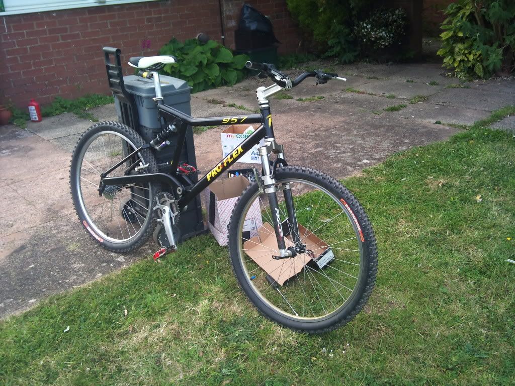

No pics from tonight though. Left my phone in my bedroom, but it looks the same as the last pic, only it now has a front mech, a (new) chain, and some grips on the handlebars.

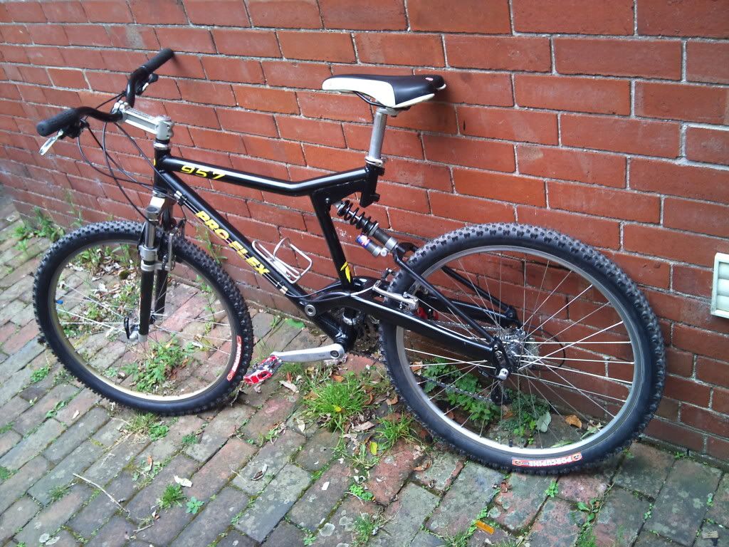

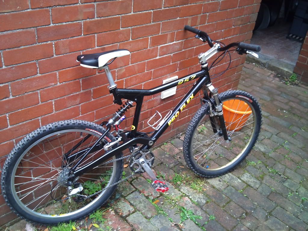

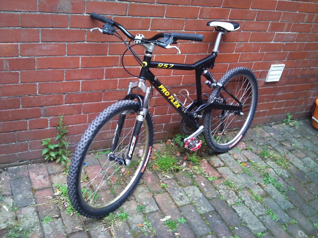

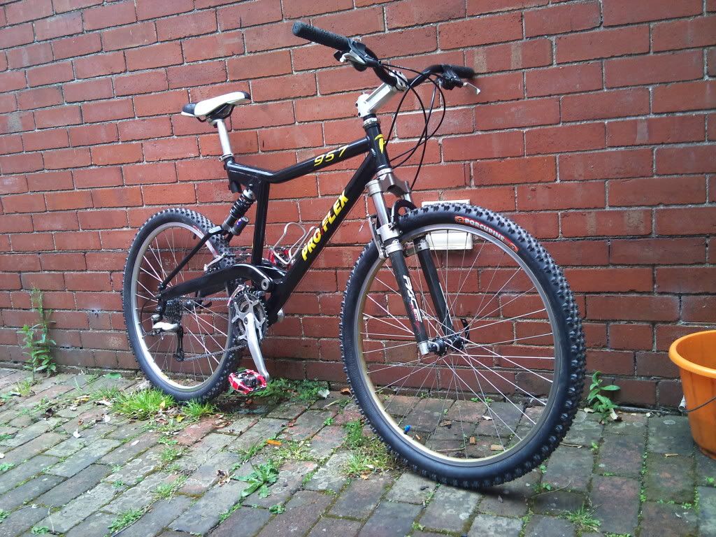

Here's some pics. Would welcome any change recommendations going forward (anyone else thinking "black bottle cage"?). I am going to be refurbing/repainting the pedals soon, so might go black with those? I do like the red though.....
Anyone else think painting the club roost bar black would be a bit much? Need something to break up the black a bit I think. It's why I took the opportunity to get that saddle (although it was free which was a bonus :D)
nice! The red pedals have to go tho' - never have liked flats like these on a cross country bike. And yes - service the pace fork - its a bit of serious history.
