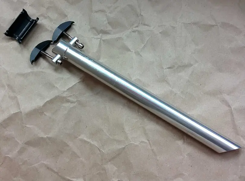

The Tune Starkes Stück seatpost has arrived. It's a really simple design though slightly fiddly to initially install, but I was only half awake. The instructions say it's easiest to attach it with the saddle upside down.
There's a hole drilled through the top of the post where the bolt support goes through. The two half moon parts go above the rails, obviously. The half pipe section rests in the post cutout and supports the underside of the rails inboard of the uppers. They're the only posts I've noticed that have the bottom cut at an angle, not sure of the reason behind it. Weighs a featherly 169g.

It looks good!
The reason for the angle cut is weight saving; the longest side goes on the front where the pressure is applied against the frame tube, while its cutout material would not suffer stress, so they cut it...
Ah OK, truly weight weenie. It is slightly fiddly installing it unless you have 3 hands but not enough to make you throw it out of the window.
