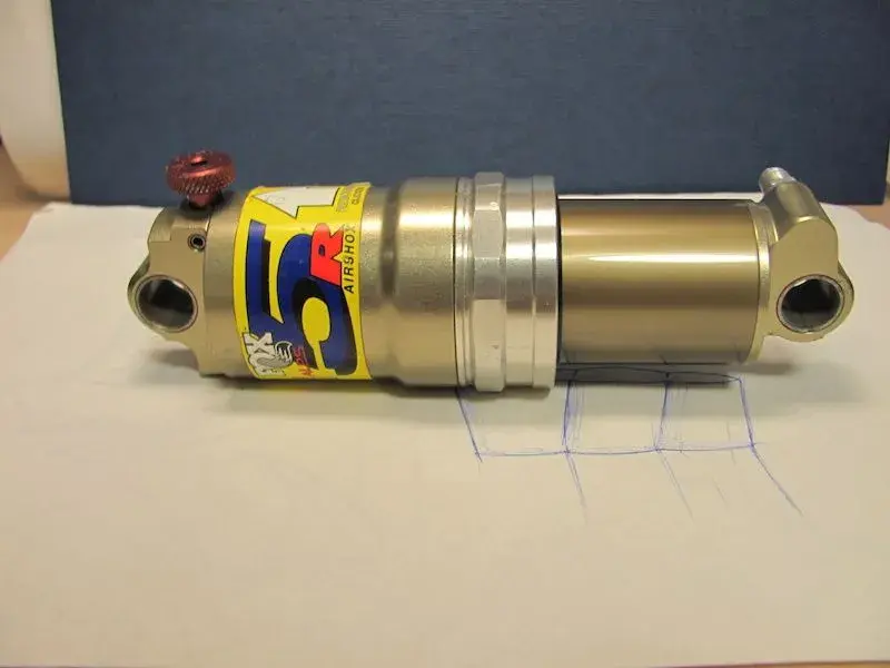

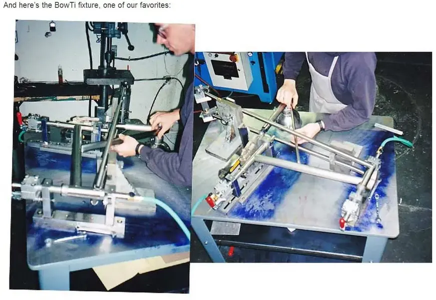

Chris Hayes is the man I was told did the bulk of the welding, It would not surprise me if you are right and despite the huge price tag there was not much profit made out of the Bow Ti. Dating is pretty difficult but whatever - they are rare, late '90s and pretty unique. 6.5 inch eye to eye extended shock. I have the original Fox Alps 5 unused and ride with an RP23. Geometry was optimised for 70mm fork travel so it sat midway between the current XC and downhill forks of the era. The frame with the shock removed is sitting just under half way through its designed travel. So it had to be jigged and welded to that state - makes your head hurt just thinking about it. If you have not seen it, Google Ibis 30/30 and look at Sebastopol days Pt2 there is a picture of the Bow Ti jig. Good luck with the build and put some pictures up when you are done. As Scot says "Get out there and ride that thing!"

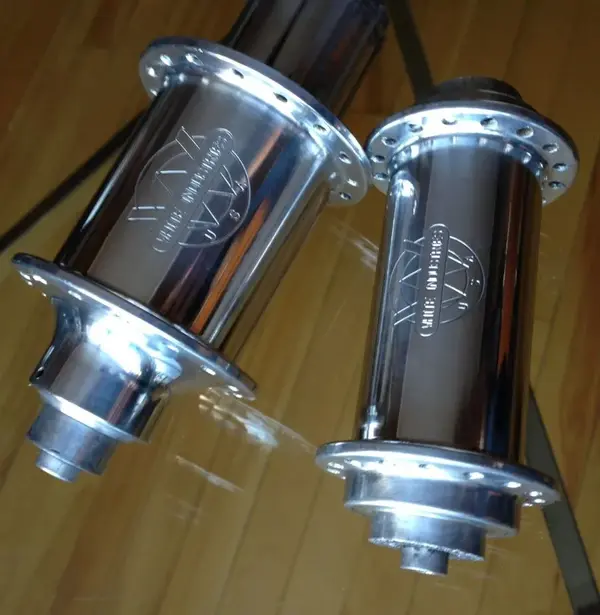

A few updates here...am taking my time with this one, waiting for just the parts I want to come up..
-Very nice second gen White Industries hubset (tracker front).

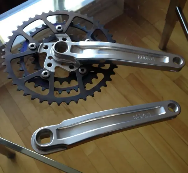

-Now this is a crankset! NOS Kooka with NOS Actiontec Titanium 44,34,24 rings and bolts...ELG heat treated...was actually suprised how well they fit together!
The search for an NOS 1997 Judy continues...

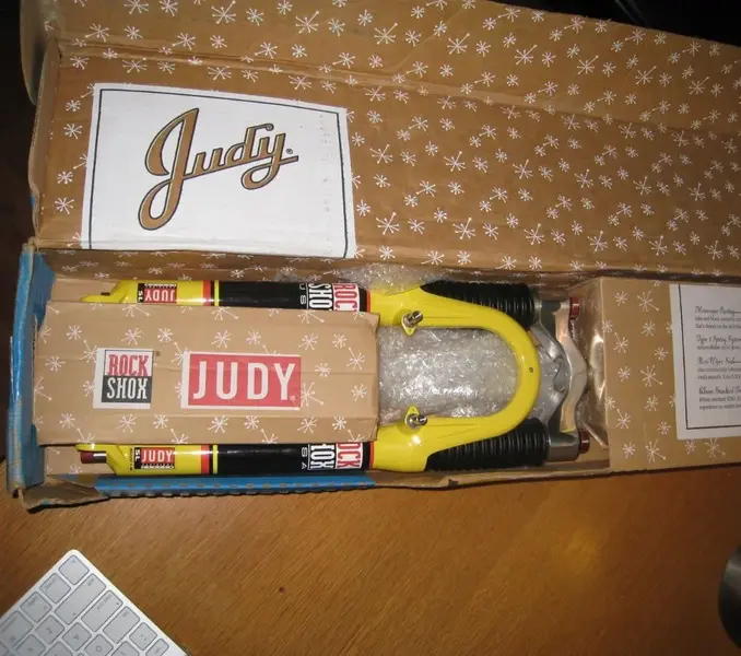

I almost feel guilty using this...NOS 1997 Judy SL :(
Pretty much had no choice but for NOS as I need a 9'' steerer!
PS: It wont be yellow for much longer..

Your going to repaint nos Judy lowers?
Why not find some SL lowers and repaint those? He'll I'll trade you my lowers...

You are probably right...when I get to it I probably wont be able to start peeling away the decals! Maybe I will leave this one in the glass case..plus i really do want an 80mm..back to ebay I guess!

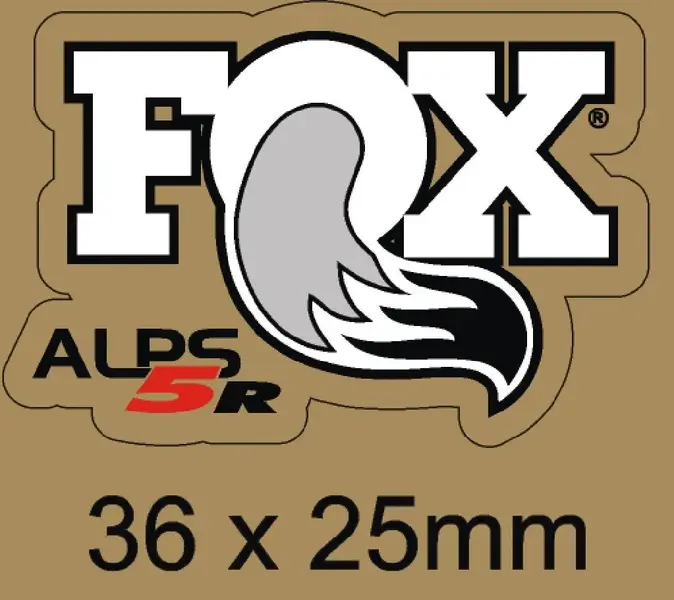

In other news Gil M and I have come up with a new decal design for the fox alps 5r. I find the factory one basically ruins the bike!...what were they smoking at fox in 1997!

Judy's can run 80/100mm it's just if you want to rebuild them yourself. What guts you want to run, spacers and bushings.
I'm rebuilding a 97 Judy xc which was 63mm. And using 2000 xc guts/80mm.
Because really... All these old Judy's even new are still old. If you do real ridding it's with a new fork. :)
Judy is for the. Oh yeah... Olde days...
On your Ti I would personally go terralogic or white bros.

I choose the Judy sl as it is most iconic fork from the era in my opinion. That's sort of the rationale behind my component picks. Kooka cranks have a bad wrap for breaking and the company went down in flames... I like that! (My gen 3 cranks didn't have any issues however)
