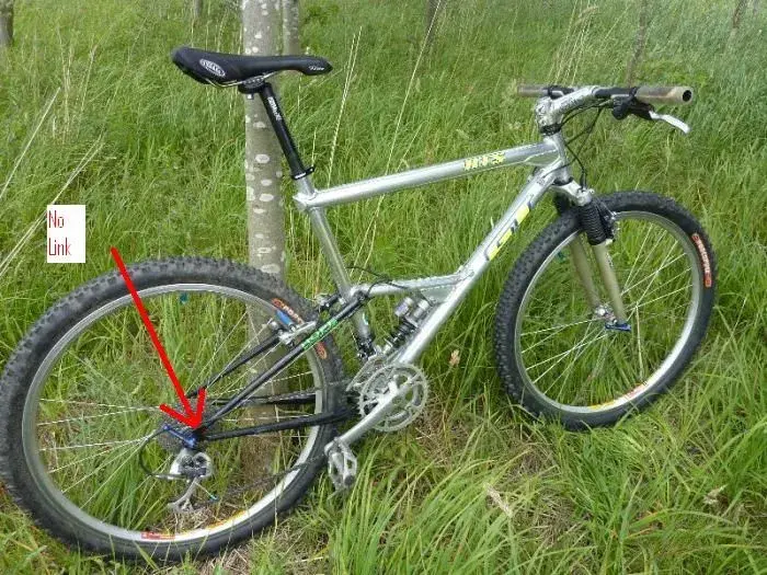

1996 Mystery GT RTS
Oh, you mean a pivot down by the rear axle?
That's the only thing I notice. Interesting...
Pickle's is just like mine. Do 2's and 3's have any frame differences?
yup that was only on the teams and 1's in the early years
i assume the 3 got that in its last years
2/3 main frames are the same as far as i know but the early 3 had a steel rear end
Yes, this is the only difference in frame design. See pics.

Looking at past catalogs all RTS 1,2 and three frames with the aluminum rear triangle have the pivot in front of the rear dropouts. Drawing a comparison to a frame with a chromoly rear triangle is like comparing apples and oranges and really serves no purpose. There really is no difference on the frame references between 7000 and 7005 either. One year they refer to it as "7000 series" and the next year they are just more specific in calling out 7005.

i'm pretty sure the first version of the ali backend had NO extra
pivot
also the first rts 1 had a steel backend
mikee":884haiet said:
i'm pretty sure the first version of the ali backend had NO extra pivot also the first rts 1 had a steel backend
1993 was first year the RTS was introduced and all 1,2 and 3 had a chromoly rear end. 1994 when they went to aluminum rears they all had the link in front of the rear dropout.
