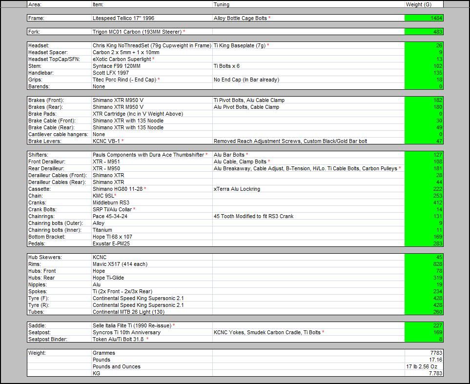

Looks good, Still some areas to improve upon weight, I have had sub 18lb myself.
Latex inner tubes, Titec pork rinds, EC90 bars, saddle such as an SLR or San Marco Aspide, Tune hubs on Stan rims, Dura Ace cassette, pedals, chainset? maybe a Duo?
I ran it single speed with Hugi hubs, Avid Mags with ti hardware, Easton carbon post and bars, and Titec Phat ti stem, and Judy SL though my previous Dean ti had worked out as a lighter build due to Pace rigid RC31, I sure I had under 16lb single/rigid, just over 16 geared rigid and under 18 deared with sids back in my weenie days, still remember how the Supersonics sang on tarmac
