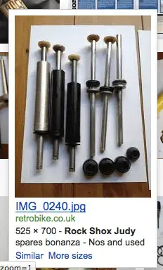

what fantastic info and great advice better than LBS! - I will be looking into rebuilding some '96 / '97 SL's soon, can you buy the transfers (black large upper) anywhere and is there any advice on removing and replacing the bushings as I need new ones.
Steve the Dummy Leg & Oil Damper leg that go inside the Stanchions look like this Pic attached. All that sits on the top (it pops onto the top of the metal rod) is the white washer/bush/rebound thingy??? The Springs just then drop into the stanchion then you screw the adjuster on...BINGO!
Hope this Helps??
Hope this Helps??
cheers fella, very helpful, yes.. 8)

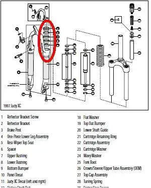

Also, what I was refering to above, was the top 'seals' on the outers. As per the pics below, when I pop the cap off, there's nothing but the bushing up top, in there, is this right..? The exploded diagram I've been looking at suggests not.. :?
Steve, what's the diagram? I have one. I'm certain you're not missing anything. I would have done the same for Paint. I can't recall anything else going in there? The only thing you may be confusing something with is the sponge wiper that sits on top of the seal under the boot, but I never put these on...
PM me an email & Ping you the diagram I have to see if it's the same...
Yes. Same as what I have...
No, I don't believe anything is missing. 5, 6 & 7 You can't get at without the right RS tools to remove the bushes. Number 5 is a bottom bumper (Dunno if this ever could come out?). In mine it was rooted at the bottom of the fork, never took it out for fork respray nor the bushes, didn't look like it was affected after paint or shotblast before.

The bottom rubber is the 'bottom out bumper', they do come out. spokes are good for that.
The other part you think you are missing is a 'foam ring' insert. But that was introduced in the 1997 spec probably. Not the earlier 95/6 spec you have.
Nope that is the only seal you have, as there is no oil or air to worry about. Just a simple dust/dirt wiper.
