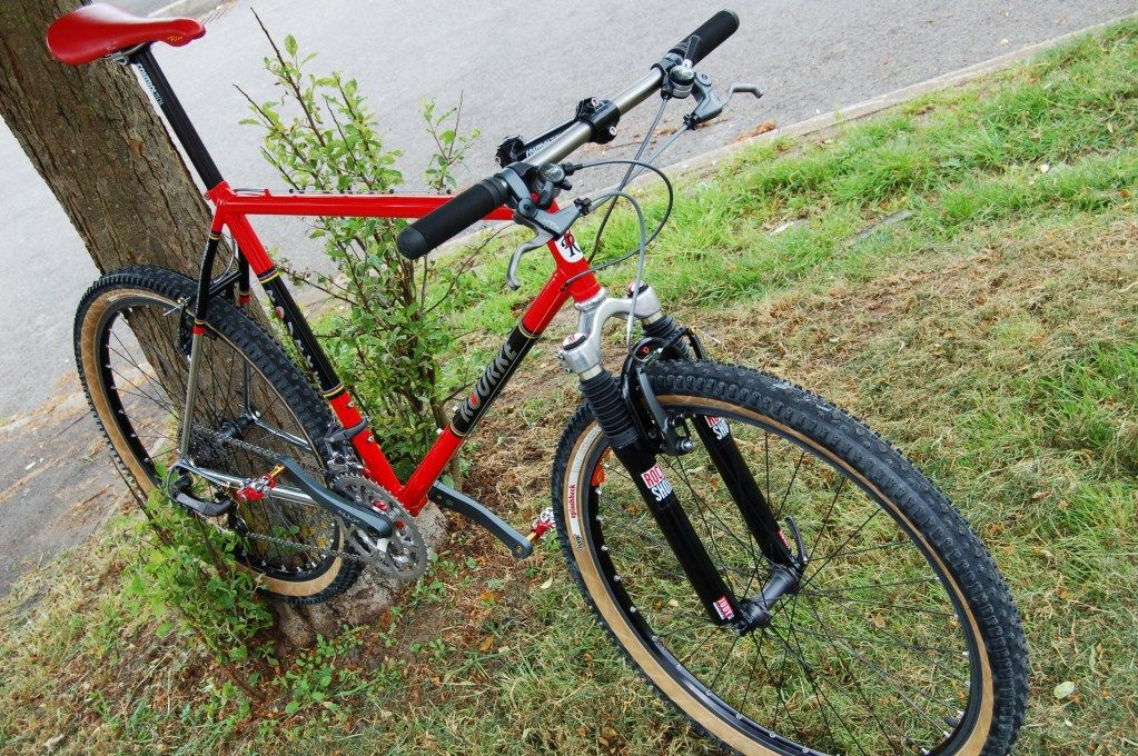

They now ride brilliantly,
as fitted (today) to my Rourke.. 8)
Just rebuilt the cartridge on a set of 96 Judy XC forks. Found this guide very useful indeed.
I've gone for 15w oil as I'm running coil springs and need an extra bit of damping. I'll have to see if the original plastic cartridge will still hold oil.
