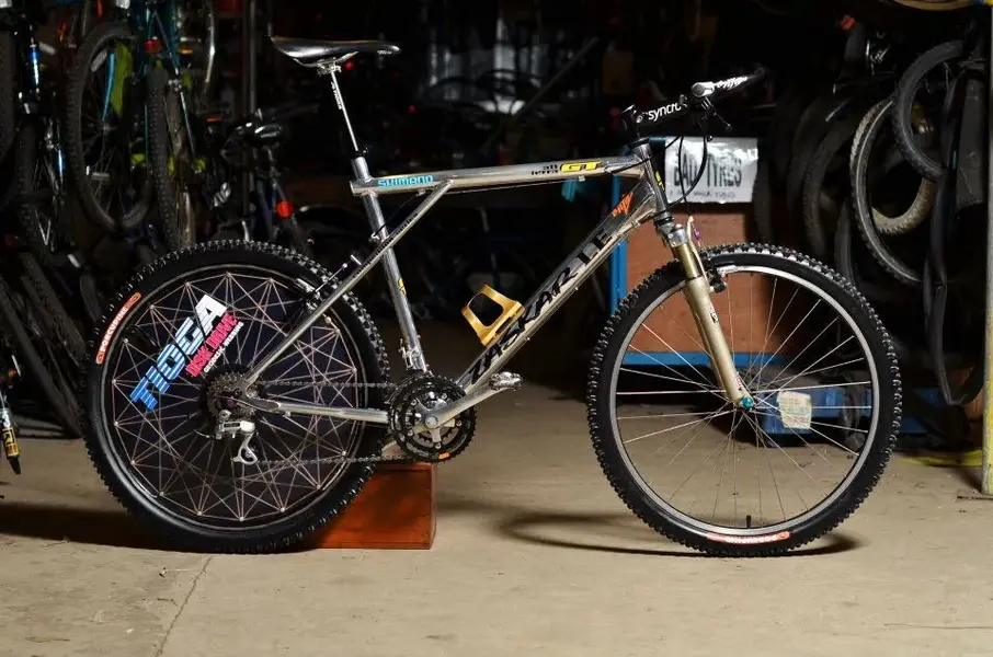

Stay with it buddy - from one Zaskar nut to another. I have just finished mine and this is the result of some mad buffing work and TLC - RESPECTO my friend! 8)
