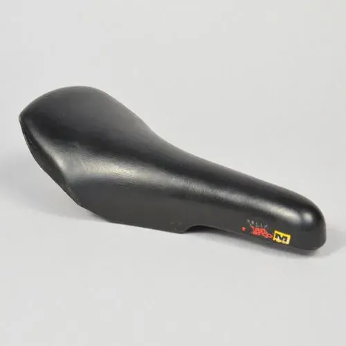

Think the saddle might be from the Selle San Marco Bontrager line...
