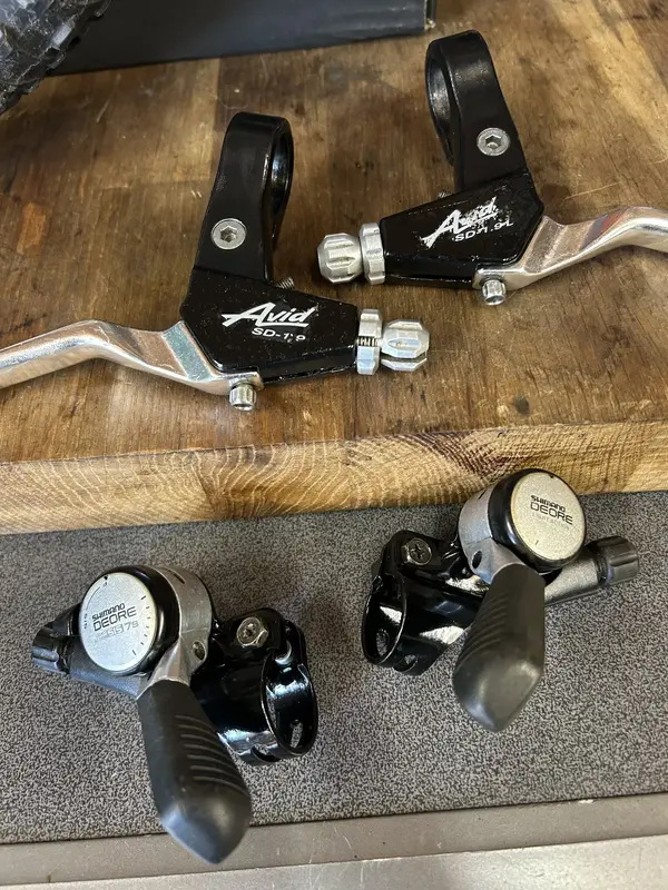

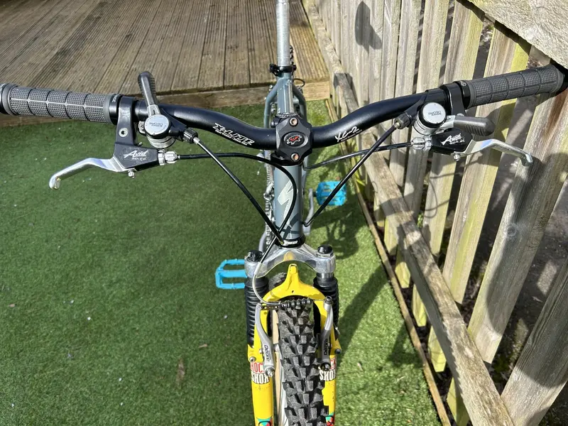

The brake lever bodies and shifter mount have had a new cost of gloss black, masked the ‘AVID’ logos off so will need to do some touch ups around them by hand once they dry.
Lever bodies have new black paint. Did what I could to keep the Avid logos, not perfect but better than before. Paint around the logos needs a bit more drying time then I’ll replace what’s on the bike.

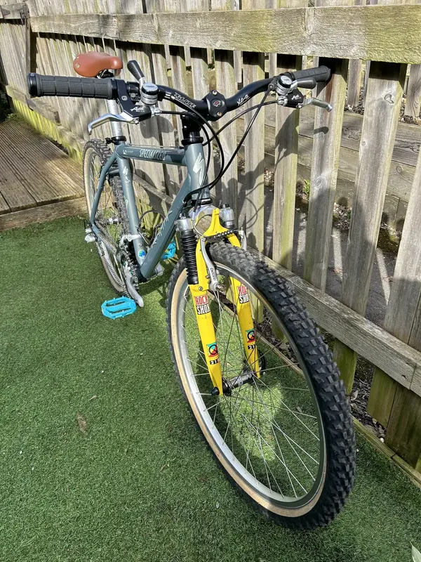

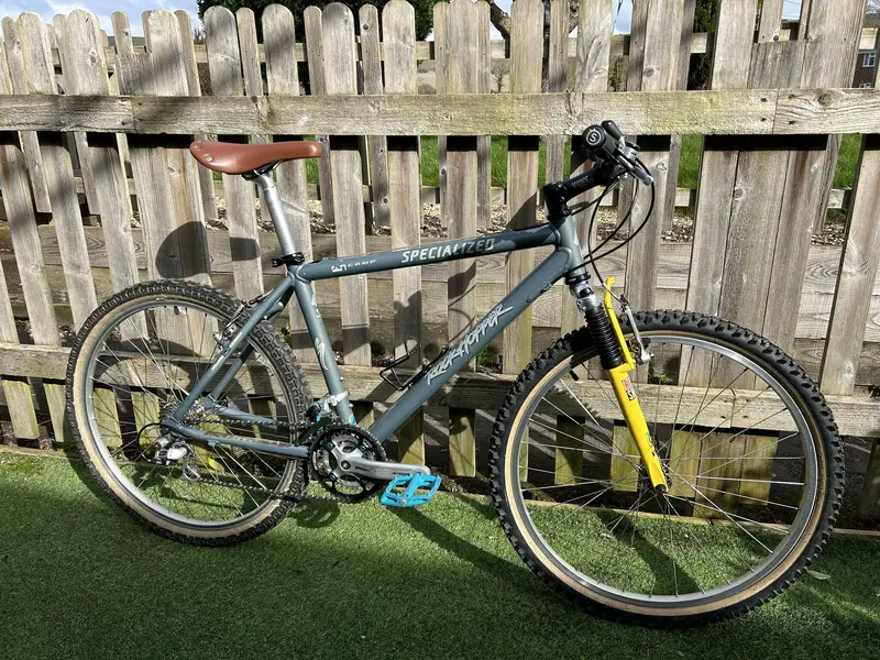

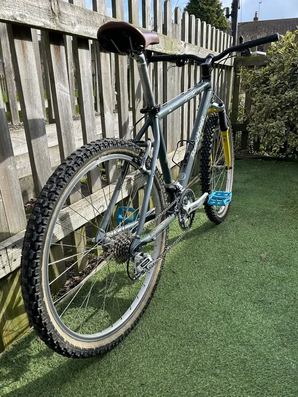

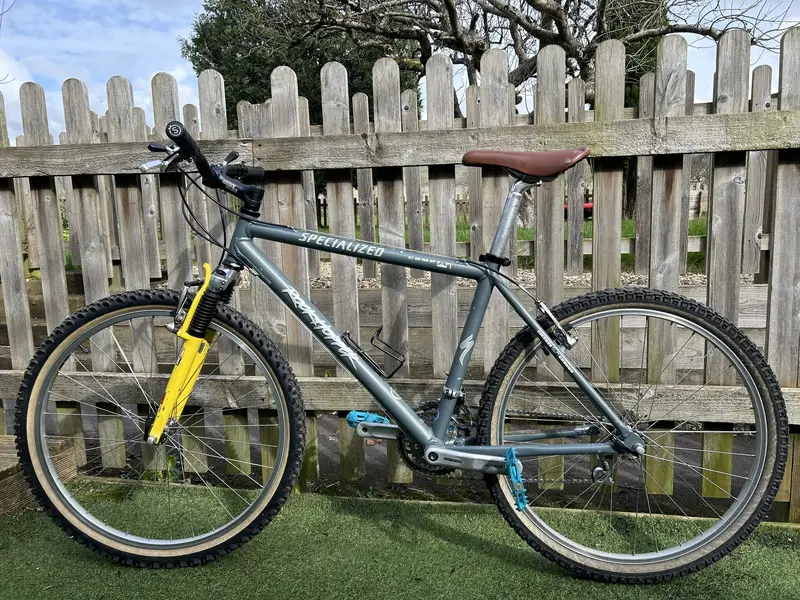

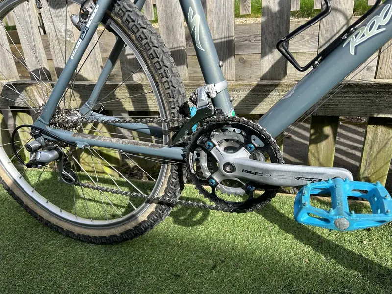

Finally finished, quick spin around the village to check everything works and feels good. Loving the thumbies and the nostalgia of riding a parts bike like I would have had mid to late 90’s.
It’s a spritely ride, weighs 26.25lbs.
Pics of the bike built up plus my parts build from that time.

Frame: 18” 1997 Specialized Rockhopper A1Comp Aluminium frame
Fork: RockShox Quadra 21R rebuilt with spring/elastomer internals from a later Indy fork
Headset: FSA Orbit XL II
Stem: RaceFace Prodigy Forged ahead
Stem Cap: Specialized
Handlebar: X-Lite XC-2 7075 alloy 35mm rise
Grips: Orange Strange
Barends: n/a
Brakes: Shimano Deore
Brake Pads: Jagwite
Brake Cables: Stainless
Cantilever cable hangers: n/a
Brake Levers: AVID SD-1.9L
Shifters: Shimano Deore thumbies 3x7
Front Derailleur: Shimano XT
Rear Derailleur: Shimano Deore DX
Derailleur Cables: Stainless
Cassette: Shimano 7 speed HG41 stainless/drilled (new)
Chain: KMC-Z (new)
Cranks: FSA Dyna Drive
Crank Bolts: Shimano
Chainrings: FSA outer, Shimano middle and grannie rings
Chainring bolts: KCNC blue anoside/ FSA
Bottom Bracket: Specialized 73x110mm sealed unit
Pedals: DMR V6’s
Hub Skewers: Shimano STX
Rims: Specialized Z-23’s
Hubs: Shimano STX Parallax
Nipples: Brass
Spokes: Stainless
Tyres: Front - DURO tanwall, Rear Specialized tanwall Ground Control
Tubes: Panaracer
Saddle: Tan leatherette brass studded with alloy rails (new)
Seatpost: Alloy
Seatpost Binder: Specialized quick release
Weight:26.25Lbs

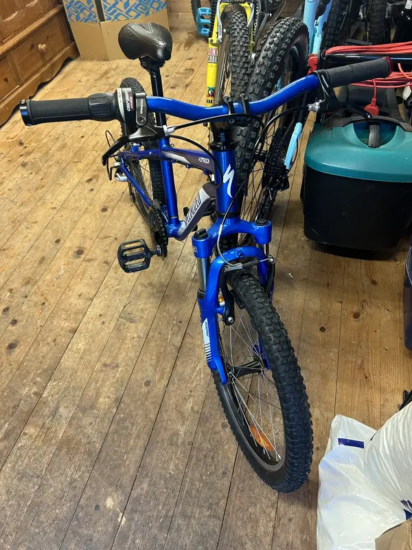

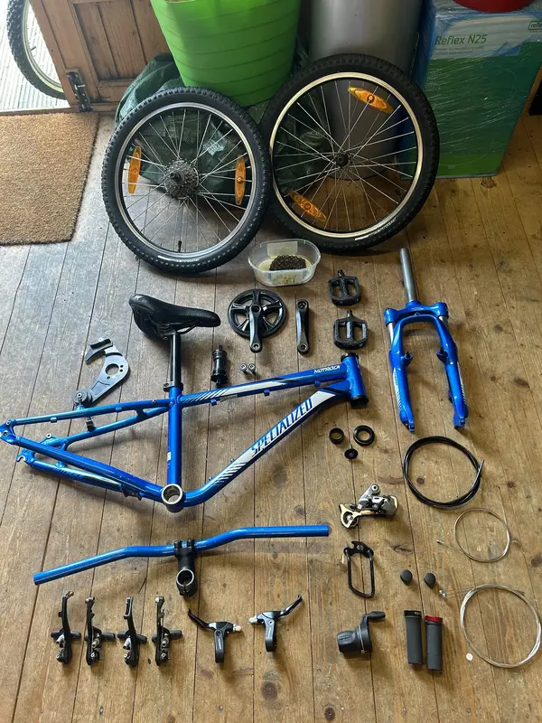

Just finished the mini Specialized Hotrock too, it’s now sporting the STX rear mech from the Rockhopper as the Tourney one was knackered, hence the addition of a mech guard too. Save those drop damages 👍
