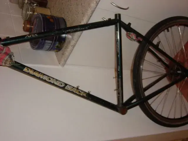

Neil: no, the bike is definitely a 1995 model. See attached photo. Its partly stripped but you can see that it has a metalic green tint.

Rear mech was Deore LX, front was STX, Brakes levers were Dia Comp Power 7's, brakes were Shimano STX, gripshift shifters, Sugino 175mm cranks, Deore LX hubs, Weinman rims. Crap Avenir brand seat, stem, bars & pedals which were replaced...kalloy seat post.
The work continues. Will paint myself.

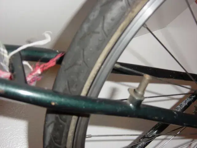

Oh, I was wrong - the bike does have cantilever brakes.
Then I definitely don't think it's a 95. The 95 colour is a matt navy blue - I have one (a 95 Apex), and I still have the brochure for it too. I have a 96 brochure, when they downgraded the spec of the Apex - kept the frame, but went down a bit on the parts, and that year's Apex was Red - may have been matt finish.
So possibly 94?
Not that it really matters, 'cos the frame seems to be the same one they used for a few years on the Apex (True Temper TT Lite custom butted steel).
