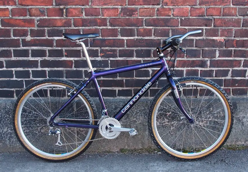

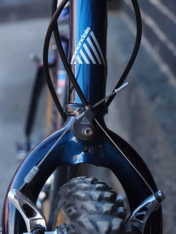

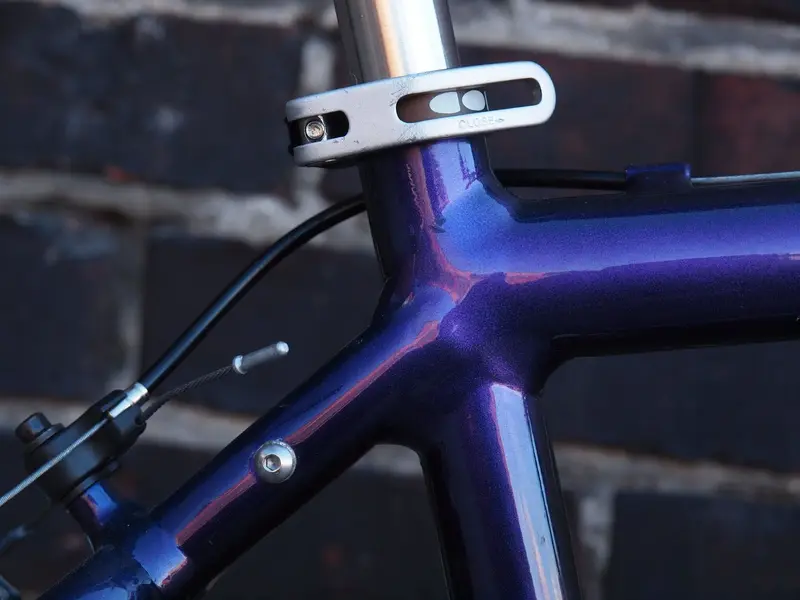

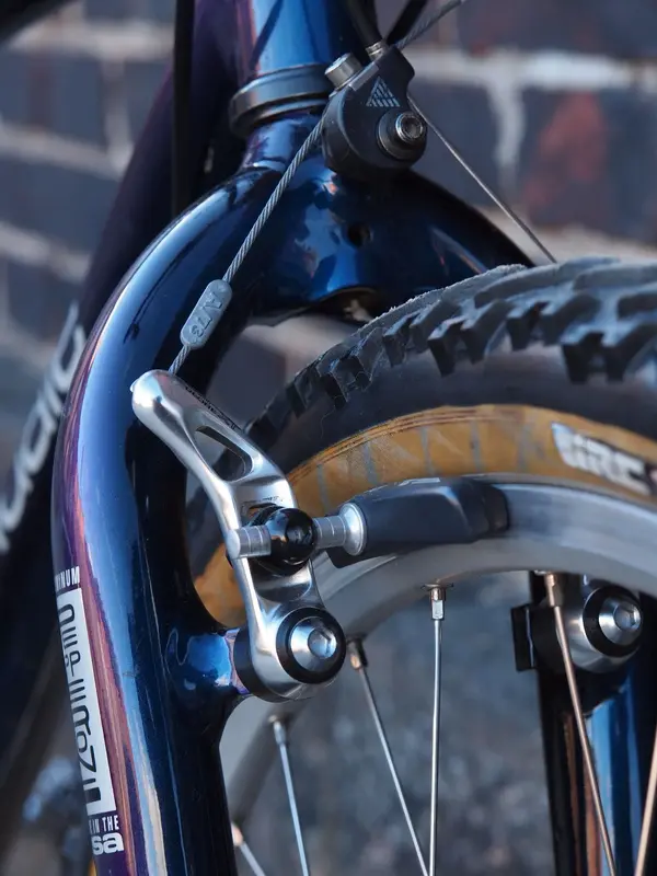

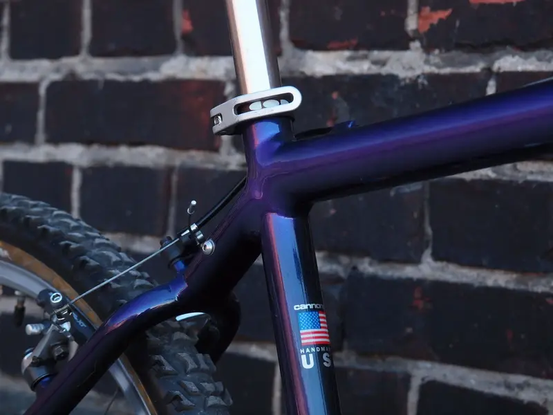

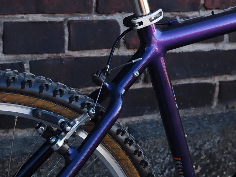

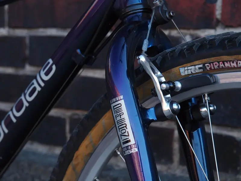

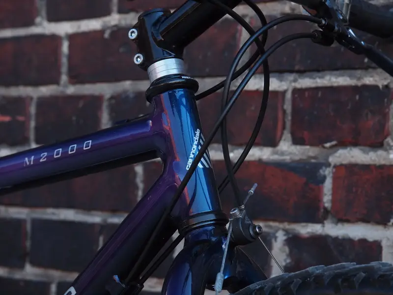

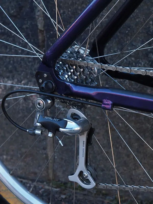

I was able to buy a started project from a friend in the hobby, as he had to reduce the number of bikes. The 1995 M2000 is the last fully rigid flagship model, as the top of the rigid range was M900 after this. Seems to be fairly rare bike, as supposingly sales turned towards F-models in the mid 90's.
The bike had almost all original catalogue spec parts, so the catalogue was the way to follow. No updates or tuning parts... except for the pedals that were missing. The catalogue Onza HO:s are not SPD-compatible, so I did put 747s (as all my pedals are 535/747). Saddle was changed to similar but one in better shape, rear cassette, chain, some cables and housings replaced and new canti bolt washers installed. Wheel QR's were changed to XT (from some no-name items) and broken seat collar qr replaced with a correct one. The broken cable doughnuts were glued intact and some minor touch-up painting done. The still original tires and rims were cleaned.
The factory specced M2000 (1995) is very understated, even shy. Beautifully painted frame build with featherweight components to supposingly the skinniest aluminium vintage Cannondale ever at catalogue weight of ~10 kg. It almost flies away.
FrameM2000 1995 S (16") 2.8 Series
ForkPepperoni
StemCODA
HeadsetDia-Compe Aheadset 1-1/8"
HandlebarCODA Competition (Easton)
GripsCane Creek
BarendsCODA XYZ
SeatpostRitchey Expert
SeatVetta TT
Seat collar / QRCODA / CODA
F.hubCODA 900M (DT Swiss)
F.rimMavic 217 SUP UB 32h
R.hubDeore XT FH-M737-A
R.rimMavic 217 SUP UB 32h
Wheel QRDeore XT
Shift leversGripshift X-ray SRT800 (1st gen.)
F.derailleurDeore XT FD-M737
R.derailleurDeore XT RD-M737
Brake leversCODA 900M (Dia-Compe SS-5 MkII)
F.brakesDeore XT BR-M737
R.brakesDeore XT BR-M737
B.bracketBB-UN71

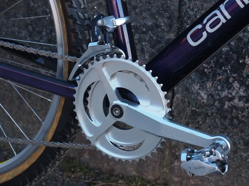

CranksetCODA 501M / RaceFace Turbine Forged
ChainringsCODA 501M 22-32-42 / Syncros Hardcore

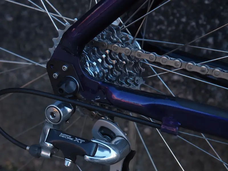

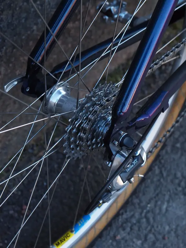

CassetteDeore XT CS-M737-8
ChainCN-HG71
PedalsPD-M747
TiresIRC Mythos XC 2.00 K (R&F)

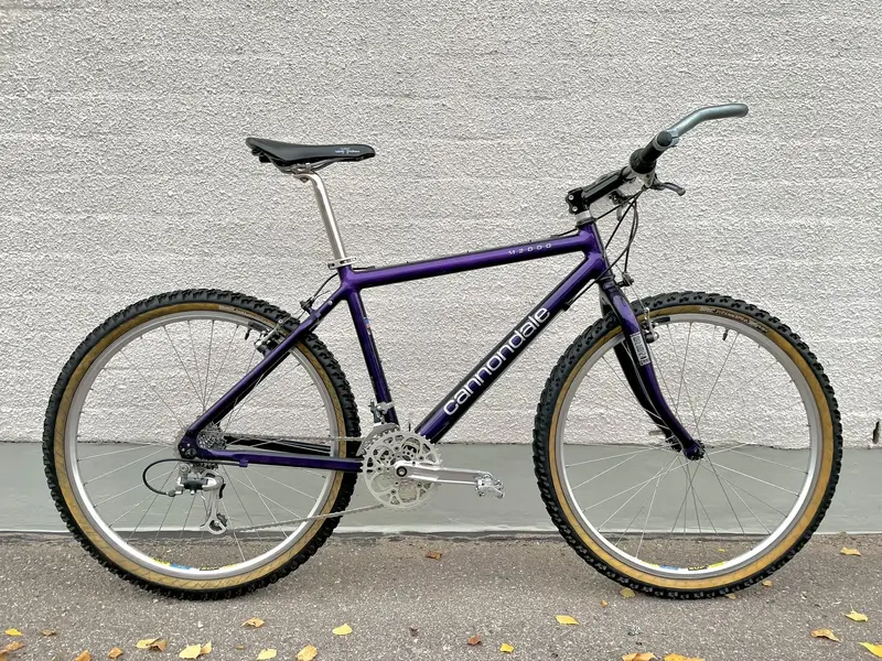

Some more photos.

I think these are the early clear cracking ones, but the code is SRT 800X-81 (rear) and 800X-11 (front). I think I have CODA front skewer somewhere, but the XT is of lot better quality :)
Did not like too much the looks of the Coda M501 crank/chainset. So When I found these RaceFace cranks with Syncros chainwheels, I decided to make a swap. The Cranks were originally anodized red, but really worn. So I did deanodizing and finished them with polishing. Suits the bike really well, with the bluish gray colour of the chainrings. The M501s are stored well if the need to factory spec arises. Too bad the Syncros middle ring is really worn, so looking for replacement part for that.
