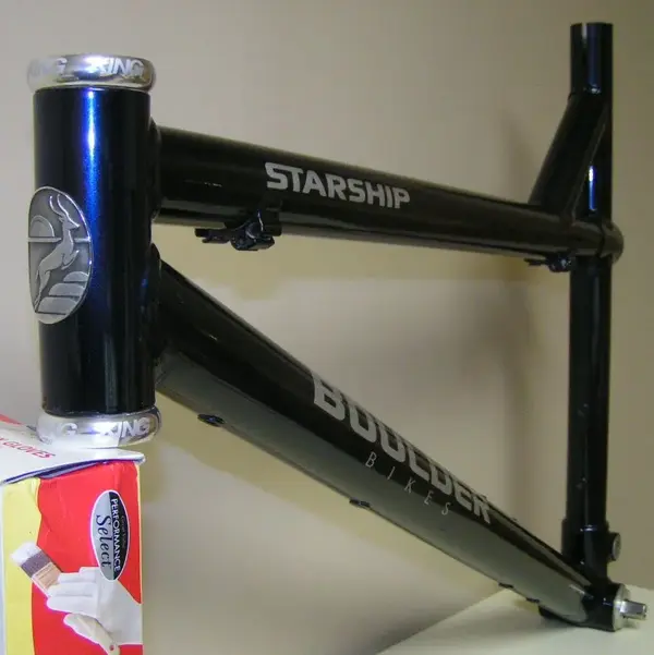

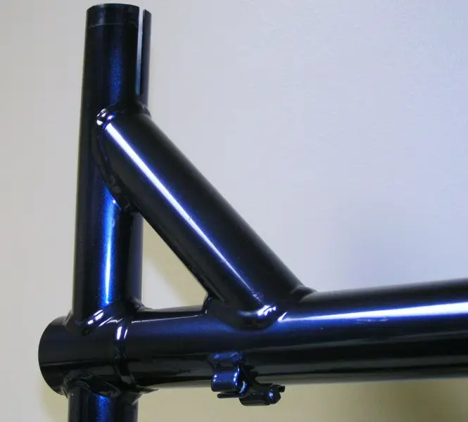

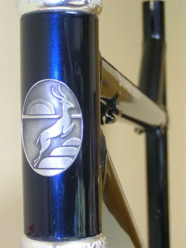

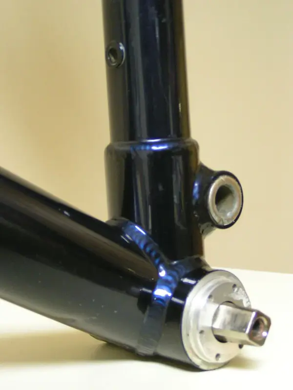

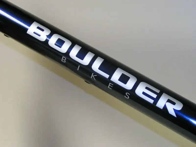

The frame is now shiny!
The the combination of two grades of rubbing compound, polishing compound, and polish has really brought the frame back to life. It still needs a protective coat of wax or two, but for now I thought I would show progress wth new shiny photos!
Some of the shots are comparable to the earlier scuffed shots and you will definitely agree that frame looks way better. Couldn't do anything about the flaked off paint as I have not found any color match - I would have to strip and redo the who bike. Not up to that for now.

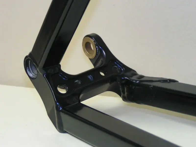

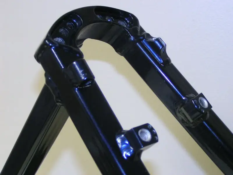

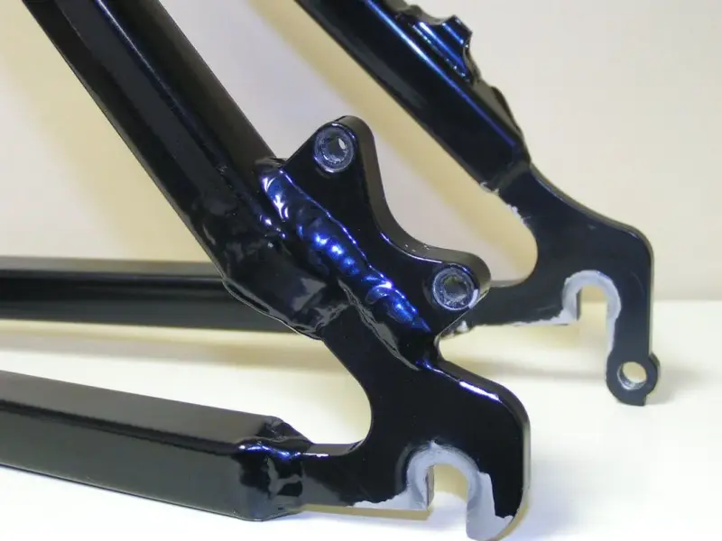

And now the rear triangle. This is a lot more battered - even though it now shiny, I can't hide the fact that the mud and gloop on The Chilterns has stripped a lot of paint. Then there's the damage from chain suck, chain slap, and the wheel axle...
I'm wondering what the bike would look like with a stripped and polished rear triangle with the dark blue front end....? Well its not something I am going to try now.

I reassembled the frame tonight and gave it a second polish and a coat of wax. I would say the frame is done.
I discovered that the swingarm bearing is on its last legs. It is tight for now with no slop in the rear but only just. Next time it is serviced I am going to need new bearings and a pivot bolt. As Boulder Bikes do not appear to respond to their email address anymore, does anyone know where I can get a new bearing?
I also stripped down the front disk now, and I have started overhauling the Pace RC36 Evo II forks. That was a surprise. I have a split bottom out elastomer and a rusted up circlip inside the forks. Guess I have some new parts to order......
