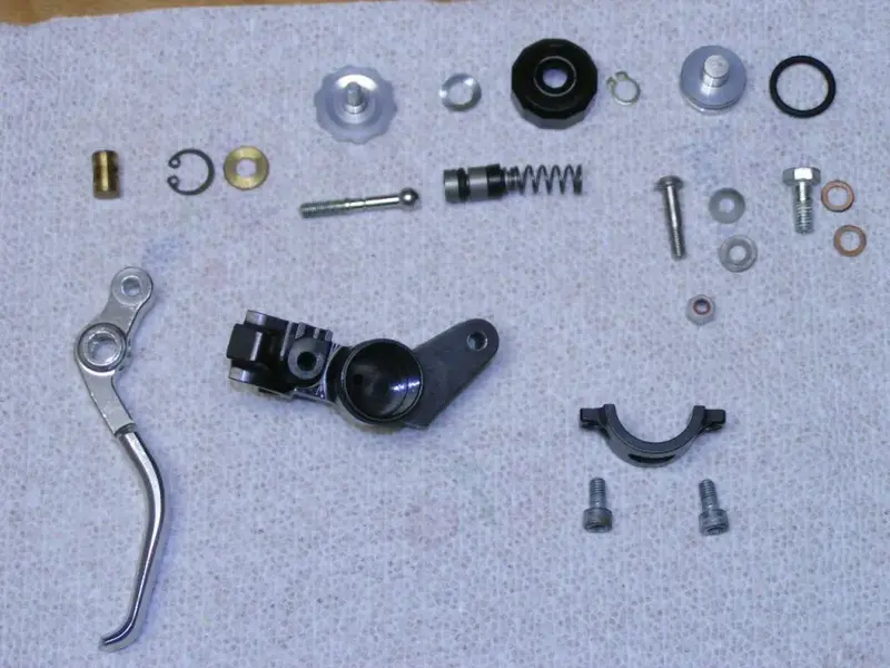

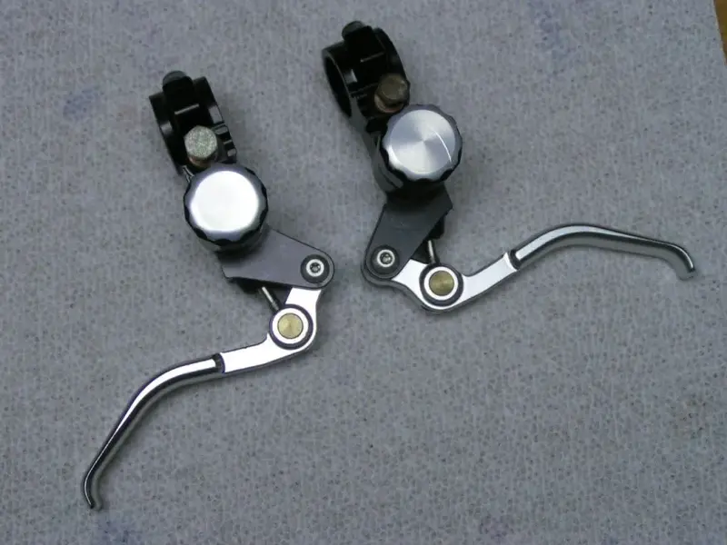

I overhauled the other brake lever this weekend and its condition was distinctly different from the other. This one, used for the front brake basically looked pristine. The seals looked like new, the oil was clean. All in all it could have been new, rather than 10 years old.
The first lever, for the rear brake, has a secondary seal in the master piston (make three seals where as the other lever and the service kits only has two), corrosion in various spots and on the hose clamp. Could not be more different.
I have discolored the rear disk before through heat build up on long downhill descents, so I am wondering if I have boiled the brake fluid before and if this boiling can accelerate corrosion of the brakes?
Anyway, regardless of the conditions both brakes have new internals so hopefully I will not have to worry about them in the future.

A few days back I overhauled the brake levers.

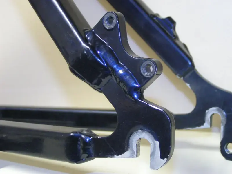

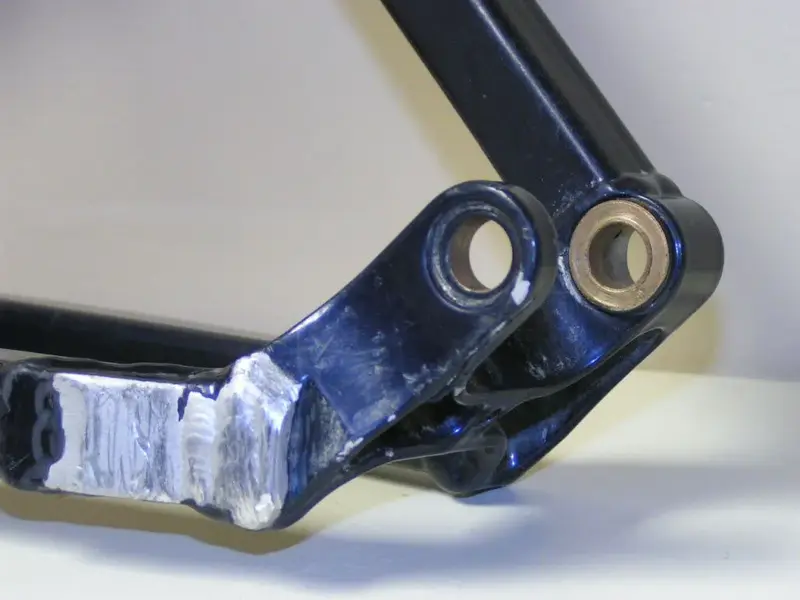

Okay here are the frame photos. The frame has been stripped of everything bar the headset and the bottom bracket (I have no need to remove these).
These are of the rear swing arm..

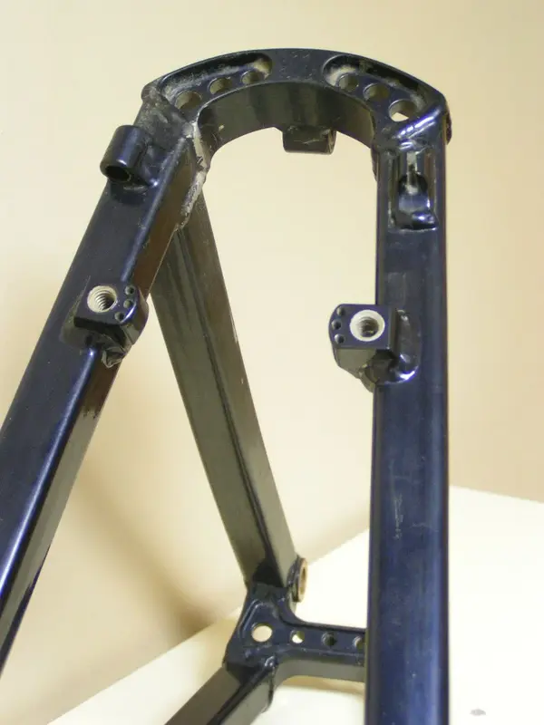

These are of the front triangle..
