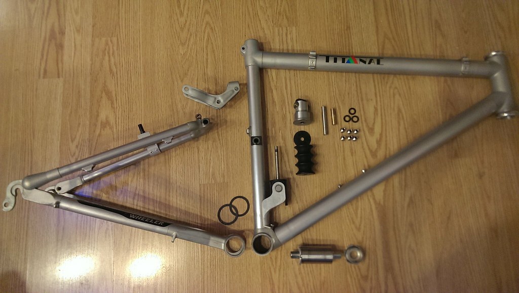

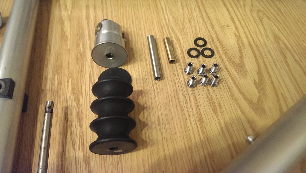

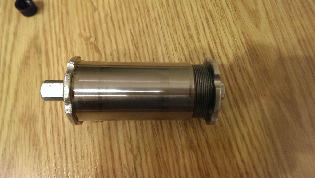

I finally got around to disassembling the bike. Found out the black coil looking thing for the rear shock is just a rubber bumper. It looks like the whole thing is held together with chain ring bolts. The bottom bracket has a sleeve that the cups thread into and the chain stays pivot on that sleeve.
I haven't been able to get the drive side bb cup out of the sleeve. Seems to be seized in there.
Here are some pics.
Simple and quite elegant- I like it.
The only part which has me scratching my head a little is the rocker. It looks like it's made from pressed steel. It would require a lot of effort to make the tooling needed to produce that. I'd have expected some machined alloy part on anything 'boutique made'. That smacks more of far eastern mass production to me. :?
Still cool though 8)
The rocker is definitely alloy but it's not fancy. I don't think I would call this thing 'boutique' by any stretch of the word. I can't find any kind of serial number or markings on it either. If I was placing bets, I'd agree with you and say that is was built in Taiwan. It is kind of cool but not really my style. I ended up listing on ebay tonight. I had fun tinkering with it for a while though.
