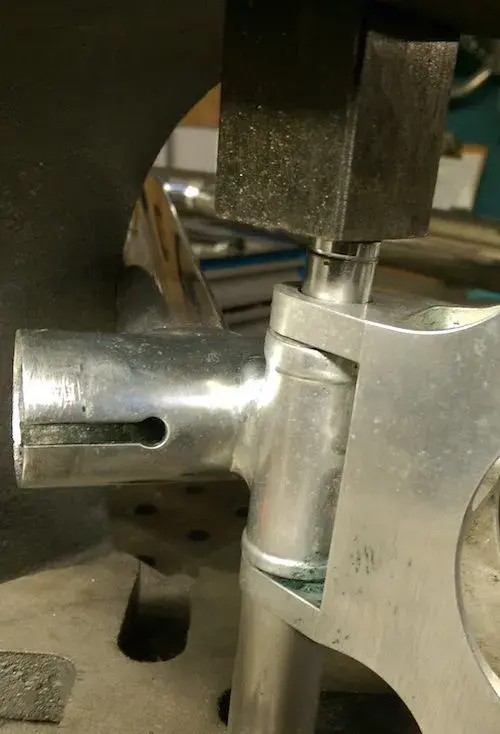

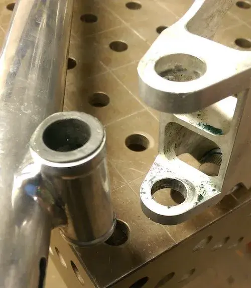

Rich passed this over to me to get the pivot tubes out.
Someone has given them a good hammering and expanded the ends.
Luckily the very thin forged lower yoke has not cracked...

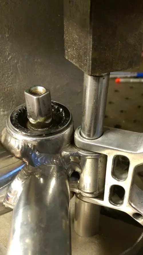

I cut two sections of tubing, one 3/4" OD with a larger internal diameter than the 5/8" OD of the pivot tube.
The other is a 15mm OD steel tube, slightly smaller than the 5/8" OD of the pivot tube.
Arrange them all in a press and, well, press:

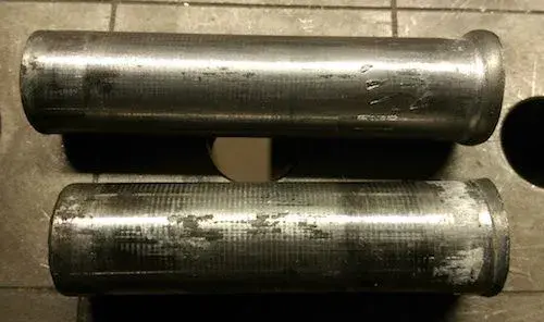

The ends of the pivot tubes are too badly burred over to rescue, so I'll source some stainless 5/8" OD tubing to make some new ones.

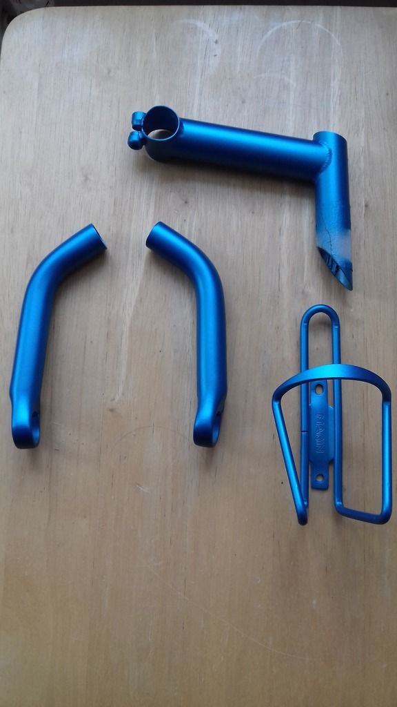

Secondly i got the stem, bottle cage and bar ends back from the painter eventually yesterday.
They look a bit darker than they actually are in this picture.
