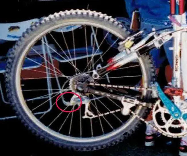

One new thing I spotted last night after reading through some unrelated Manitou posts was that it looks like it had a Avid Rollamajig. It's just a blob in the photos so hadn't noticed, seems like a silver one. They seem to have been a popular upgrade on Manitous. Not sure what year they came out, '93?
Re: 1994 Manitou DH
Hadn't noticed as it blended in with the chair but that's what I think is an Avid Rollamajig.
