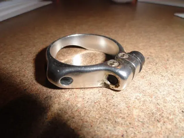

Today I found the infamous rear brake seat tube collar in my LBS's parts drawer - still looking for a local 1 1/8 Impact headset.

I found the Impact collar piece for $1 at this excellent used bike place - Main and 17th if you're in Vancouver!
