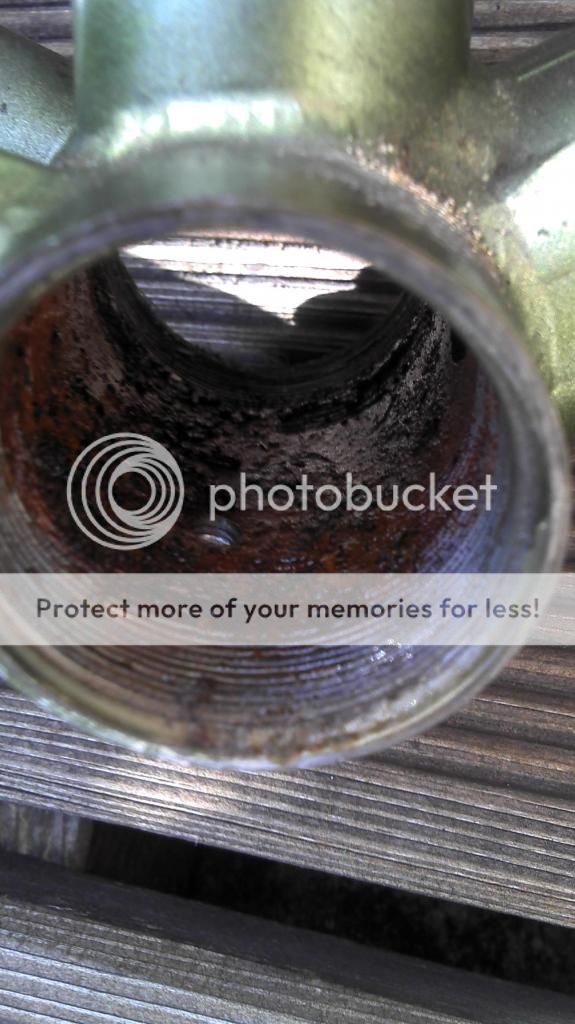

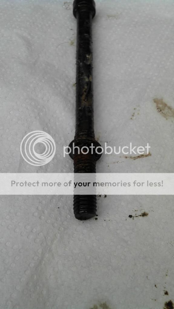

two things made me worry, if the buy had been a good deal or not: quill stem and BB :(
when I first tried to remove both of them, I failed - nothing moved. First I soaked the quill stem bolt in rust remover solvent for more than a week. The first try with a standard allen key was a miss (bend the key :x )
Something more "professional" had to do the job:
and it did and the bold came free :D
The other parts of the stem had been greased prior installation, so they came out easily, but the bolt had not been greased
When the quill was solved I turned my attention to the BB.
Had to put a lot of force with the BB tool until the BB comes out and again the threads had not been greased and rust hold it back in the frame.
now its time to do the bare frame and give him some TLC.

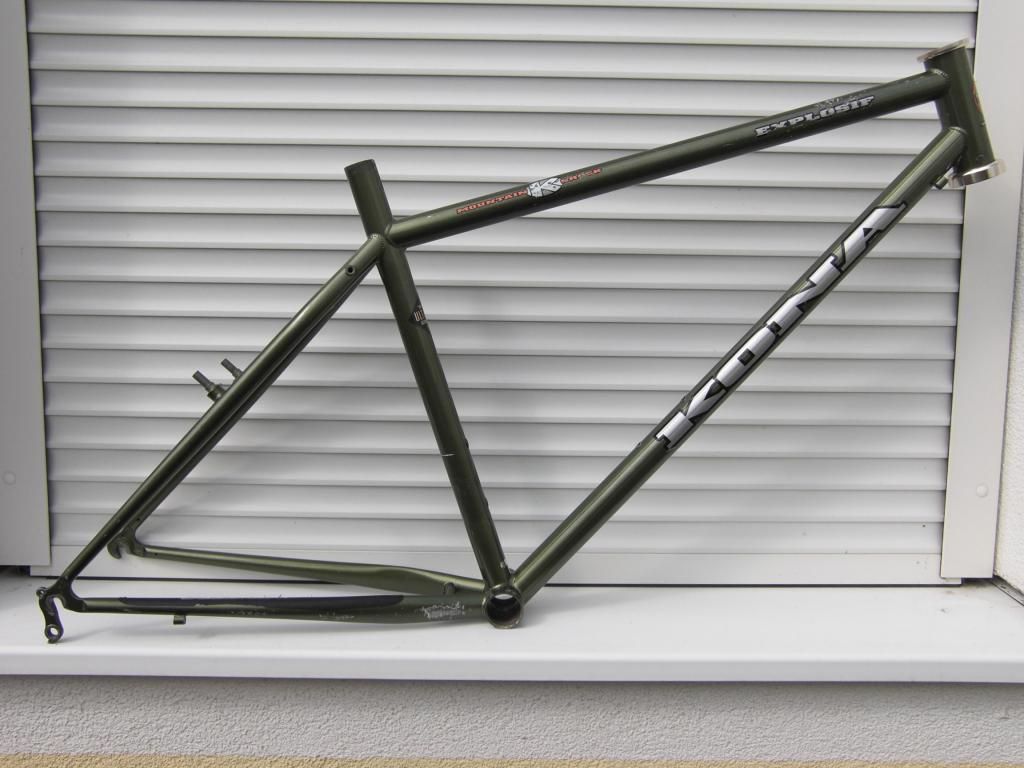

magas":2syc4rc9 said:
interesting, was not aware of that. Maybe the reason is, that Kona in 94 offered different specs. for North America and for the rest of the world. At least there are two different catalogues here in the archive.
The US brochure says about frame tubing "Tange Prestige Ultimate // Race Light DB stays" wether in the other brochure they tell "Tange Prestige Concept / Ultra Light custom set // New Extra Light DB stays"
Going to weight the frame when its completly dismantled.
Maybe this was allready discussed here before, but I did not find some. Who can enlighten us here ?

Now that's interesting, once again from the don Anthony. So, 2 variants - nice one!
thats truly interesting with those two variants of the 94 Explosif - was not aware of that - thanks for enlighten us :)
@ kikideparis: Your Explosif looking good, btw. :wink:
The weight of my frame is 1.948 grams incl. the 2 headset cups (dont know the weight of it)
The frame's ready for rebuild
The 94 Tange Explosif and my 96 Columbus Explosif sitting together - both 18"
Wether the 94 weights 1.948 grams the 96 weights 1.917 grams
