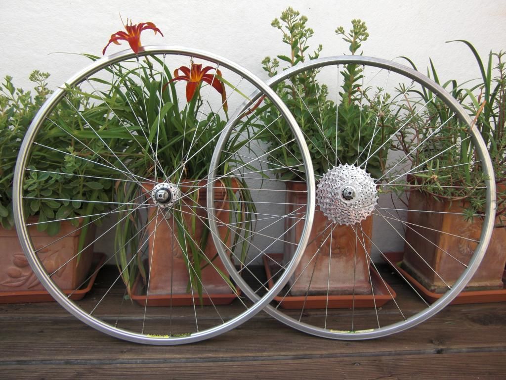

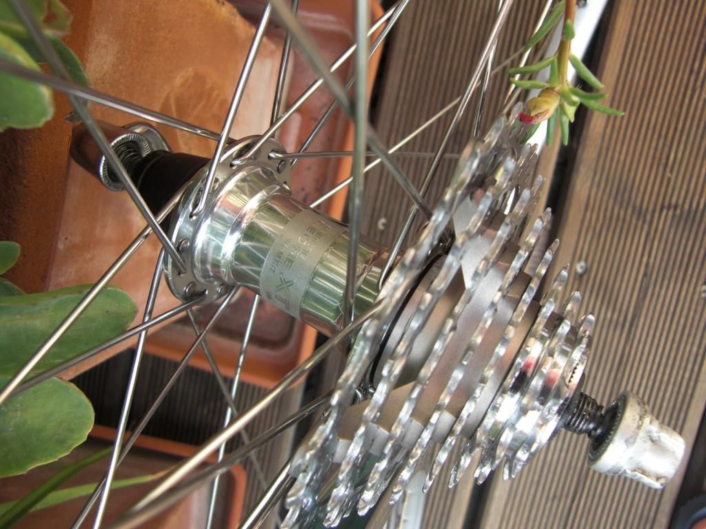

rear Mavic 231 rims lanced to XT freewheel-hub. front are Mavic 230 and also XT hub. I changed the casette to a XT 12-32 which is more suited to the terrain I used to ride, than the 11-30 which comes original with the bike.
heres the wheelset ready for the tyres
Nice job on the wheels.

What's your tips on making whelk and cassette so clean?
