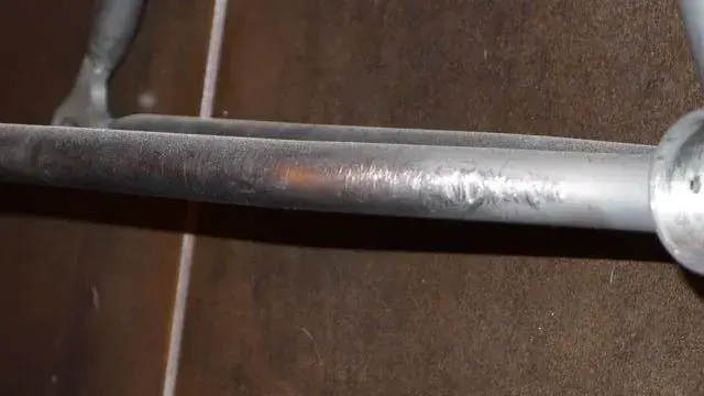

Do you guys know what is the wall thickness of the chain stays of these frames? I can't find any info from their catalogues and am still waiting to hear from Litespeed.
I just bought one and it has some damage from chain suck. Some of the scratches (scrapes?) are deep and it worries me a bit - I'm debating whether I should return the frame. :?
I have this pic for now but I'll take better ones later - maybe without flash.
Thoughts?

How deep is those scratches? Maybe try photo from another angle?
Was it cheap enough to justify those scratches?
Maybe around 0.5-1.0 mm.. I'll lay a flat piece of metal against the scrape when I take another pic later.
I got it for 250CAD or 155GBP for you guys in the UK.

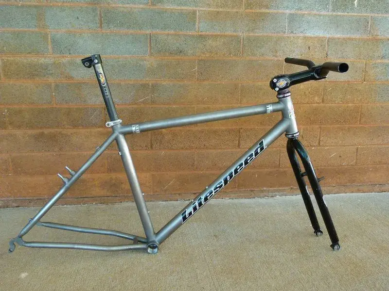

Hmm, If its meant for You, then probably build it up and ride. Depends what plans/expectations You have?
You know where to look at (it isn't hidden damage) just for peace of mind.
But really, it is up to You! If You aren't comfortable with damage,then return.
To be honest at that price it's still a bargain!
The frames of that date are not very sophisticated in tubing (I have a 1994 Catalyst) as you can tell from the weight. I think you will be fine. People tolerate chainsuck of that level on steel frames which usually have thinner walls.
It's a 1994 frame with a much later downtube decal. I don't know the tube spec, but it's likely to be around 0.9mm thick, whereas a steel tube might be 0.6-0.8.
I can't really see anything from your photo, but if the cut is to some extent a dent, what you have left isn't necessarily 0.9 less your 0.5-1.0 estimate, because the inside of the tube may well be bulged out to match. To the extent that it's a dent, I wouldn't worry about it.

It's going to be my daily driver for commuting and for local trails, so I can prolong the components on my XLM.

Yeah, the price included the fork, headset, stem, bar and post - I agree it was a pretty good deal. I heard back from Litespeed, they don't have the spec sheet handy but I was told the same thing - that back then their tubes were thicker.

I had some more time to inspect it last night and laid a ruler on the damage. The deepest cut is actually less than 0.5mm. It looked more like a scrape than a dent. I'll upload the pic later.
I think I'll keep the frame. The other thing that Litespeed told me is that if it ever breaks in this particular area, it would not be sudden and I should be given some warning before the failure would occur. I'm hoping it doesn't happen, but I'll inspect it from time to time anyways just like I do with my other bikes.
