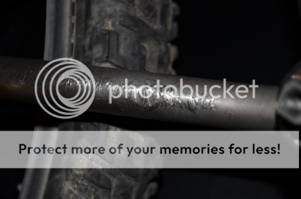

Bimdapogs":2ur7xsot said:
The other thing that Litespeed told me is that if it ever breaks in this particular area, it would not be sudden and I should be given some warning before the failure would occur.
My thoughts are, that area is hidden and cracks are unlikely to be spotted early, and that you would be best off smoothing over any areas with wet & dry, starting at 120 grit looking at the damage to reduce stress raising sharp corners. I've filed chain suck damage from much lesser frames before!
Sorry for the wait. Here are a couple more pics.
From what I can see, I wouldn't be too worried about that. Titanium is a phenomenally tough material and you have to bear in mind what caused that. You try filing titanium with a steel file, it's very difficult and the titanium tends to win. If that damage has been caused by steel chains, even if the sideplates are hardened steel, I would guess much of the lost material has just been deflected inwards rather than ground off altogether.
Thanks again you guys for your advice. The build is almost done. I just need to install the brakes and new cables and it'll good to go.
