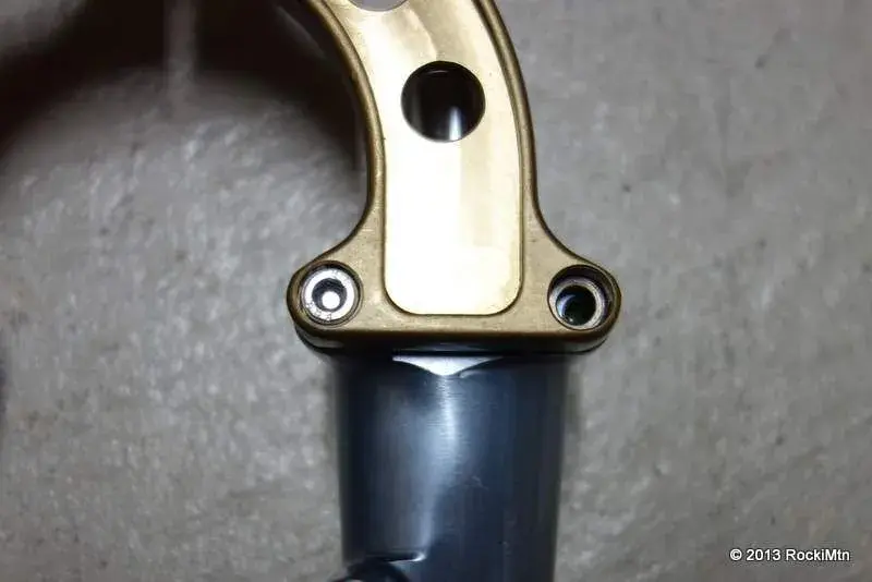

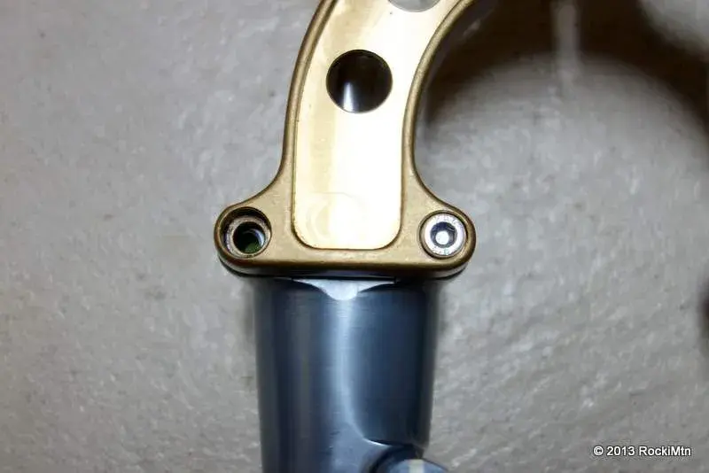

as Dr.M has stated, got the brace yest and discovered the mount holes are about 2mm off from the XC500 and the XC600/700. :facepalm: :( if you don't actually try to mount them and just compare the two braces, the difference is so slight that visually it looks like the holes line up. so instead of having solved one problem as i had thought, i'm back up to two with the forks, and needing rim(s) for the wheelset. :(
however, i did find another thread and it looks like an XC500 brace mounted to an XC700. although the cable hanger/stop doesn't look like the XC500, only the brace section. in fact in the second photo, it looks like the original brace hanger/stop has been shaved off, and the hanger looks like it's an after market add-on which i happen to have in my spares. :? i've sent a PM to skolioza to inquire. so far he's replied that he has swapped XC700 brace to XC600, XC500 to DH3? :?:

hmmm… from further discussion with skolioza he pointed out this photo of the XC500 and XC700 with the original braces on the appropriate forks. how is it possible that they fit??? is XC500/XC700 compatible, and just not XC600??? :?
he confirmed my guess that the XC500 hanger/stop was shaved off by prev owner.

well unless the brace holes were shaved/filed/grounded larger, there's no way of getting the bolts to thread in straight into the hole. it would have taken a whole lot of brute forced and mangling otherwise.
i'm wondering if i take off a millimeter of material in the right direction off each hole, i could get the bolt in straight and mount the brace properly? and would that be safe to do?
