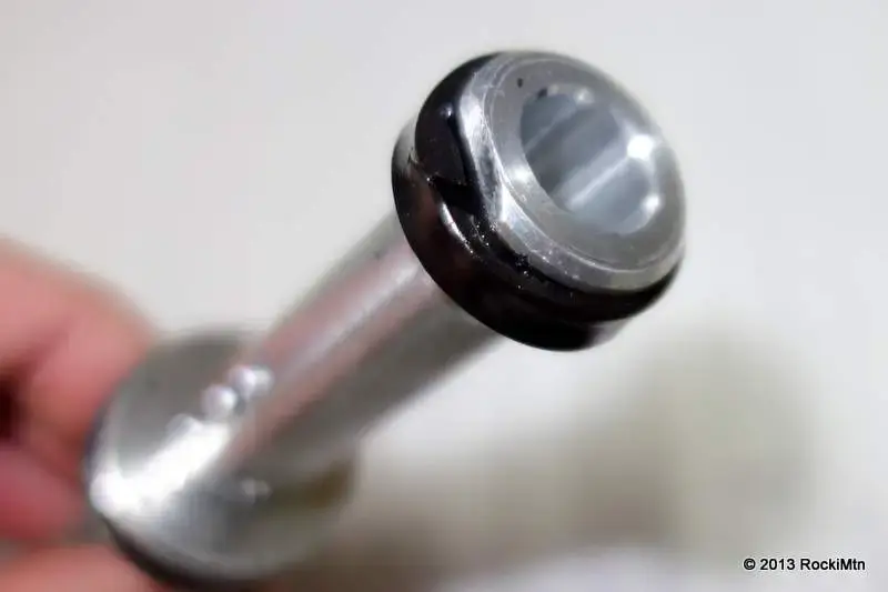

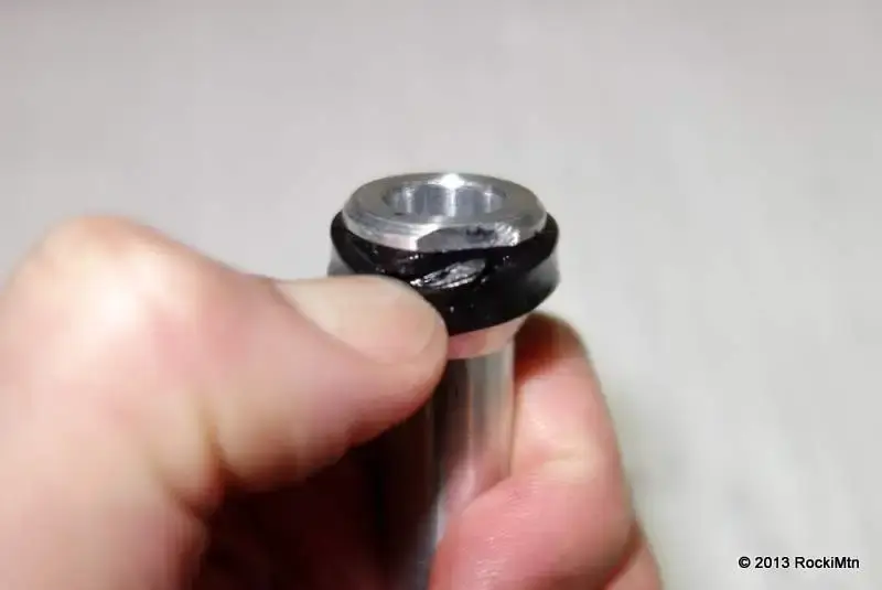

Ta-dum! got everything apart! :D
now i know where the particles in the oil from the one fork leg side came from. there's a tear in one of the seals, and it wasn't stuff off the springs as i had prev suspected! *phew*.

Regarding DSC06314.JPG: It's nearly impossible to crack this seal (I have never seen one broken in more than 15 years).
Someone who ownes the fork before you destroyed it ... is something like a cut in it?
nope, looks like it has just split/cracked, and badly at that, as i can peel down the outer portion of the seal. no damage to the top and i checked and the spring diameter has it sitting on top with no chance of contact to the seal.
Dr_M, i checked the rebuild kit you sent and it doesn't include these seals. any chance i can get a set from you???
thought having pulled everything apart, i could get this back together in no time. no chance of that now without replacing this seal. :P :(
how best should i go about flushing out all these small pieces of rubber particles?
