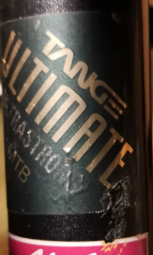

I can't see that the Tange Prestige Concept sticker will be original with it having the Tange Prestige Ultimate Ultrastrong tubing like the 93 Explosif,it should look like this.

I can't see that the Tange Prestige Concept sticker will be original with it having the with it having the Tange Prestige Ultimate Ultrastrong tubing like the 93 Explosif,it should look like this.
Agreed not sure what to make of it. I think it odd as well that it doesn’t have the Ultra strong decal on it. I did read an article somewhere that mentioned the recalling to be a little sketchy as in using old stock if they didn’t have the correct ones at times🤷🏻‍♂️

Is the paint original or has it been resprayed in the past, if it's been resprayed then it would probably explain the decals being mismatched.
93 headtube and downtube,looks like a 92 font for the Hot decal and the Joe Murray toptube one looks to be 92 as does the Tange Prestige Concept.

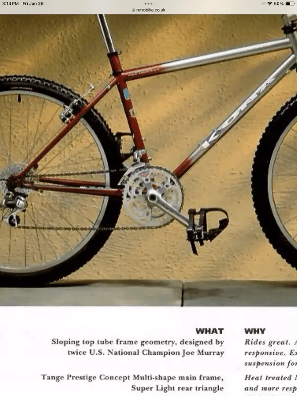

Looking at the 93 catalogue the Explosif and the Kilauea both have the blue Prestige decals. The bike hasn’t been resprayed.
For sure the 93' Explosif & Kilauea are prestige concept, it's always possible a previous owner needed to replace the tubing decal and could only source a prestige concept version, I assume your decals are above the clearcoat.
@al-onestare is it safe to say the tubing used would have to have been Prestige Ultimate Ultrastrong for a 93' Hot?

93 Explosif definitely has the Prestige Ultimate Ultrastrong tubing and that Hot has aswell you can tell just off the ribbed downtube. Plus with the Hot being above the Explosif, Kona couldn't really use a lesser tubing, imagine that.

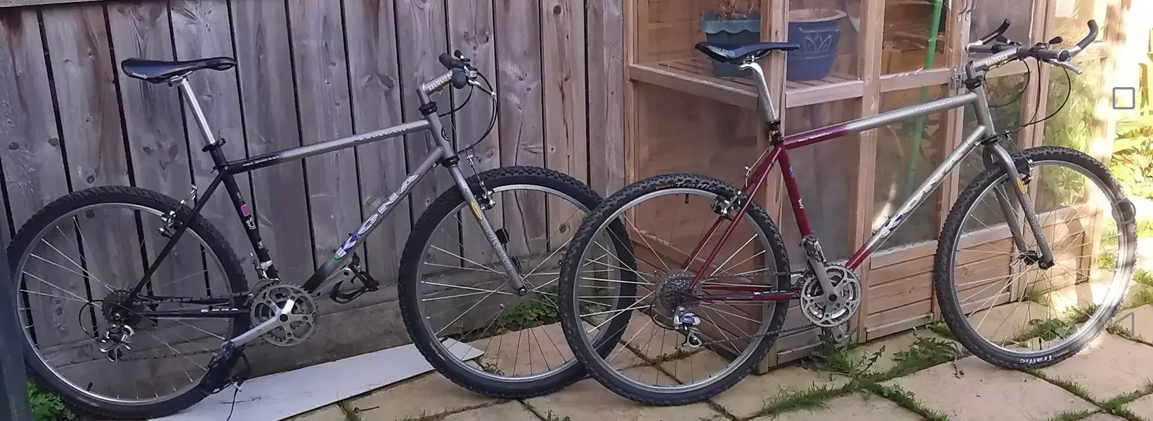

Just a reference shot for you to look at to compare the two,but this was when i had the 93 Kilauea and had it next to my Explosif.
