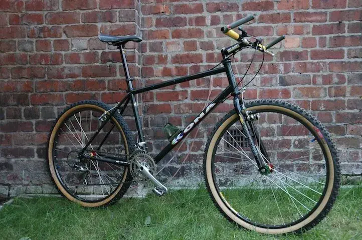

Nearly finished - couldn't resist a quick spin last night. Sublime handling (although the Moby post was typically willowy - I'll swap out for something stiffer when I do my Kona ti vs. steel handling review) and sense of acceleration.

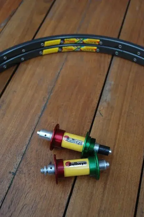

Features include the fluted Tange Ultimate tubeset (was this set used on any other manufacturers bikes??), Bullesyes, USE combo bars and a Suntour MD XC Pro groupset - although I know those brakes are going to have to be upgraded to match the speed of the frame!

Looks good Neil. Nice to see XC Pro being used and the Bullseye wheels look great too. Where did you find those NOS M231s though? I assume you just found them at the back of your lock-up, all forgotten and dusty.
Where those Tioga Wonder Dawgs in the pre-build photos by the way?
The final 'Kona against an urban brick wall' shot really needs some graffiti to complete the stereotype.
I know where you live so I'll send the boys round with the rattle cans.
Maybe they can touch up that frame while they are at it...
