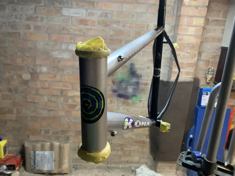

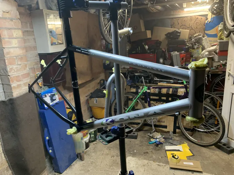

Decals arrived today from Gil. He recommended clear coating them and I wasn’t happy with the lacquer finish so I gave it a light rub down to give the new lacquer something to grip to, put the decals on and lacquered it again. I realised that I had been spraying the lacquer too quickly so wasn’t getting a decent gloss finish. Went slower this time and I’m a lot happier with the finish now.
I’ll leave it to cure for a day or so and will put it together over the break.

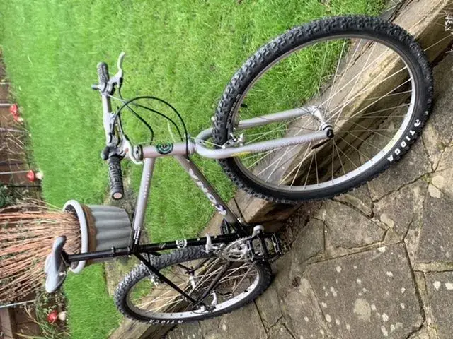

Well it’s nearly finished (except for the saddle and an 8 speed freehub)and I took it for a test ride today. It went pretty well considering the dreadful weather.
I’ll try and re cover the saddle that I want on it and I’m waiting for the 8 speed freehub to arrive.
I’ve clear coated the frame once I’d fitted the decals and I’m pretty pleased with the finished result.
