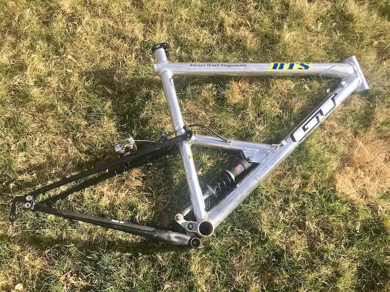

( bottom pic not of actual frame I've been offered - just as an example)

Check the rear chain stay pivots for cracks, same for the bb mount as I've seen and had some that have gone there.

I haven't purchased the frame yet so unsure of the condition of the shock. It's a low miles frame, so I'm hoping for the best. Had to ask here as one of the sticking points for me was - What if the shock doesn't work? - would I be buying something that potentially could give me a massive headache in searching for the elusive part! - Good to know I've got options.
I'll be checking the frame at those points as well - cheers for the info

The one in bottom pic is just for reference only. I haven't seen the potential purchase one yet, but I'm on the understanding it is a very original '93 with the RTS1 decal on the top tube as per the 2nd pic.
